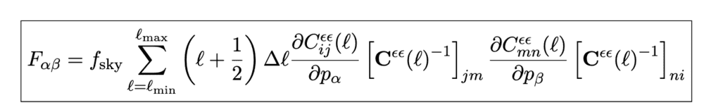

I thought that it would be higher with cross-correlation (with MLE) from the constraints point of view. For example, when we combine the Weak Lensing with Photometric probes, we have this analytical formula to compute the ##(\alpha,\beta)## element of Fisher cross-correlated :
and we get roughly a factor between x3 and x4 on classical sumed Fishermatrix Weak Lensing and Fisher Photometric.
But the MLE doesn't seem to be the right method to apply between spectro and (WL+GCph+XC).
Could anyone suggest another method to get a factor significant for this final combination ?

Of course, the original version expresses the formula of Fisher element like this :
The final expression of the combined Fisher matrix for the angular power spectra, including the contribution of photometric galaxy clustering, cosmic shear and their cross-correlation, is given in the case of the fourth order covariance by
F_{\alpha \beta}^{\mathrm{XC}}=\sum_{\ell=\ell_{\min }}^{\ell_{\max }} \sum_{A B C D} \sum_{i j, m n} \frac{\partial C_{i j}^{A B}(\ell)}{\partial \theta_{\alpha}} \operatorname{Cov}^{-1}\left[C_{i j}^{A B}(\ell), C_{m n}^{C D}(\ell)\right] \frac{\partial C_{m n}^{C D}(\ell)}{\partial \theta_{\beta}}
and in the case of the second-order covariance as
F_{\alpha \beta}^{\mathrm{XC}}=\sum_{\ell=\ell_{\min }}^{\ell_{\max }} \sum_{A B C D} \sum_{i j, m n} \frac{\partial C_{i j}^{A B}(\ell)}{\partial \theta_{\alpha}}\left[\Delta C^{-1}(\ell)\right]_{j m}^{A B} \frac{\partial C_{m n}^{C D}(\ell)}{\partial \theta_{\beta}}\left[\Delta C^{-1}(\ell)\right]_{n i}^{C D}
The block descriptors ##A, B, C, D## run over the combined probes ##L## and ##G##, thus including the three observables described in Eq. (136)
i.e. cosmic shear auto-correlation, cross-correlation between galaxy clustering and cosmic shear, galaxy clustering auto-correlation. The indices in the sum ##i## ##j## and ##m n## run over all unique pairs of tomographic bins ##(i \leq j, m \leq n)## for the cosmic shear auto-correlation and the galaxy clustering auto-correlation, while all pairs of tomographic bins are considered to take into account all the crosscorrelations between galaxy clustering and cosmic shear.

I see. I believe that in order to perform the analysis you're suggesting here you need more than just the Fisher matrices of the two experiments. The Fisher matrix describes how each experiment constrains the model variables, but no information about the distribution of data used.
Summing the Fisher matrices is the correct thing to do when the two data sets are independent. I believe the more complex analysis they're using above accounts for the fact that they are not. So you'd in essence need to follow their analysis to obtain a single Fisher matrix describing the full relationship. Then you'd just diagonalize that.
