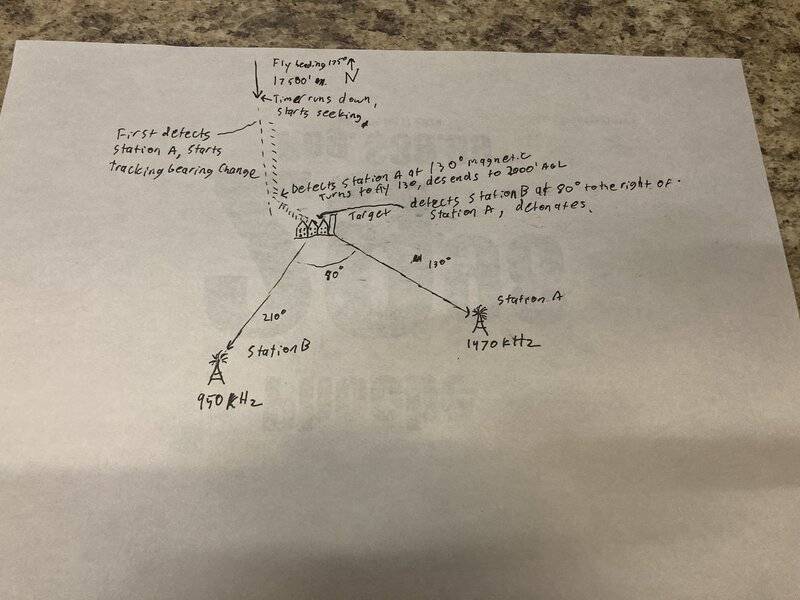

Elevation is a non-issue, but azimuth accuracy is important.
Basic premise is trying to come up with a plausible passive terminal guidance system for an early nuclear-tipped cruise missile for an alternate timeline. The concept is to use two direction finders to get a read on two separate commercial radio stations to figure out the target point after cruising on autopilot to get close. This is only supposed to be an interim measure, as widespread rollout of the VOR navigation network is still a few years down the road.
Basic concept schematic:
"Close only counts in horseshoes, hand grenades, and, well, ..."
Flyboy said:
nuclear-tipped cruise missiles
Correct. 😆
It’s not meant to be a pinpoint system, but enough to make sure you’re in the right area. A purely internal system like inertial navigation would not be practical at the time, and the computing power to do triangulation along the flight path to correct for navigation errors would be prohibitively expensive and bulky to use on a throwaway system. I figured that using the angle between two known, fixed emitters in the target area would be a fairly viable option.
That will map to a hyperbola, not a point on the ground.
Two points need a reference direction. Is your reference from an inertial system or a gyrocompass that was spun up before launch ?
No compass is needed with a three point resection, only two of the angles between the three points need to be measured.
https://en.wikipedia.org/wiki/Position_resection_and_intersection
I’m not sure I understand. If I know that the bearing from the target to one station is, as in the example diagram, 130° magnetic, and the second one is at 210°, that produces an angular difference of 80°, correct? If you know which one is which based on the frequency and know you’re coming in from one side of the target, wouldn’t that leave only one possible point where the bearings match up? I’m operating on the assumption (and I’m fully aware of the danger that represents 😆) that I can use the axis of the aircraft’s travel as a third angle. So, I can tel that Station A is ahead of me, and Station B is on my right, and I can measure the difference between the two DF seekers to tell when it’s the right place.
I was thinking of using a fluxgate compass paired with a gyrocompass. It’s available at the time, if a bit new, but it simplifies gathering direction data. A manually input magnetic declination adjustment would be part of setting up the missile prior to launch.
I’m trying to make it as simple and compact as practical. A bit brute force, as it is intended to be used by the Soviets.
That only works if you are certain of your flight path before launch.
Immediately there is a nuclear attack, MW transmitters will go off the air. Your MW navigation will only work for the first missile in the area. It is becoming more like a cruise missile than a re-entry vehicle.
