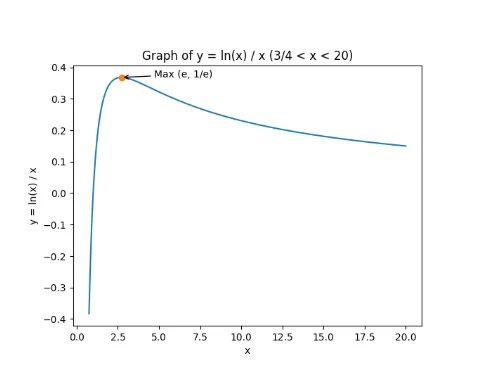

$$a^b > b^a \Leftrightarrow b\ln(a) > a\ln(b) \Leftrightarrow \frac{\ln(a)}a > \frac{\ln(b)}b$$We look at the function ##f(x) = \frac{\ln(x)}x## and note that:
$$f'(x) = \frac 1 {x^2}(1 - \ln(x))$$We see that the function is increasing for ##x < e##, has a maximum at ##x=e##, and is decreasing for ##x > e##. In particular, we can see that:
If ##e \le a < b##, then ##a^b > b^a##. (That answers the question for ##e## and ##\pi##)
If ##a < b \le e##, then ##a^b < b^a##.

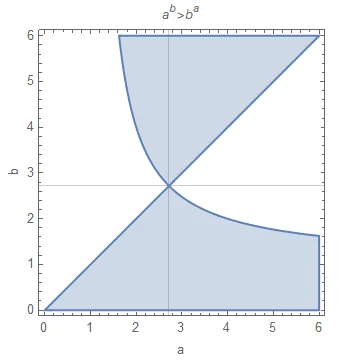

Here is a plot of the region where ##a^b>b^a##
I think your rule covers the upper right and lower left quadrants. (the quadrant lines are ##a=e## and ##b=e##)

berkeman said:
Cool plot! How did you generate it?
Mathematica has a function called "RegionPlot" that makes them very easy. Without the "pretty" options for the labels and the gridlines this figure is:
Code:
RegionPlot[a^b > b^a, {a, 0, 6}, {b, 0, 6}]

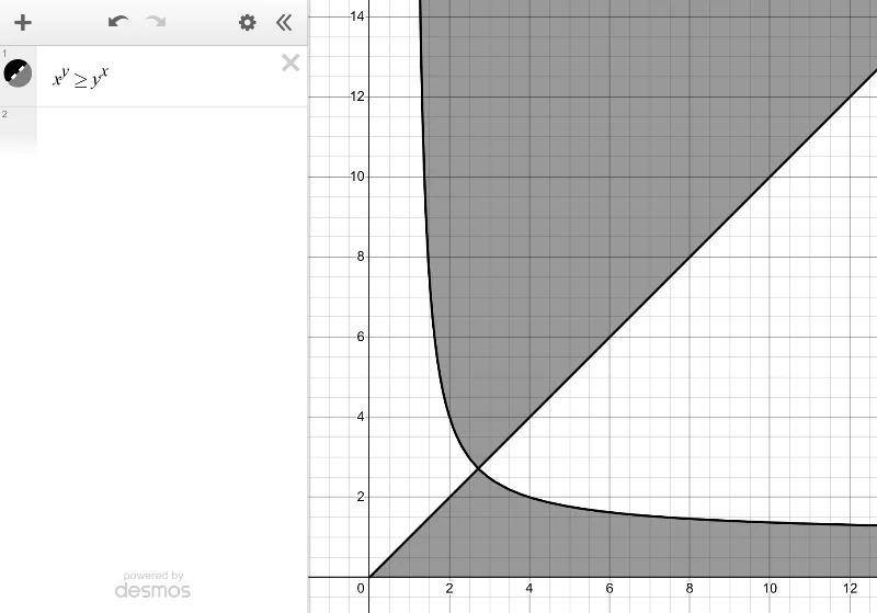

The plot can also be generated easily on Desmos.
Demos is the greatest of all time calculator. Used it a bit in high school over a decade ago, and it helped me visualize math concepts.

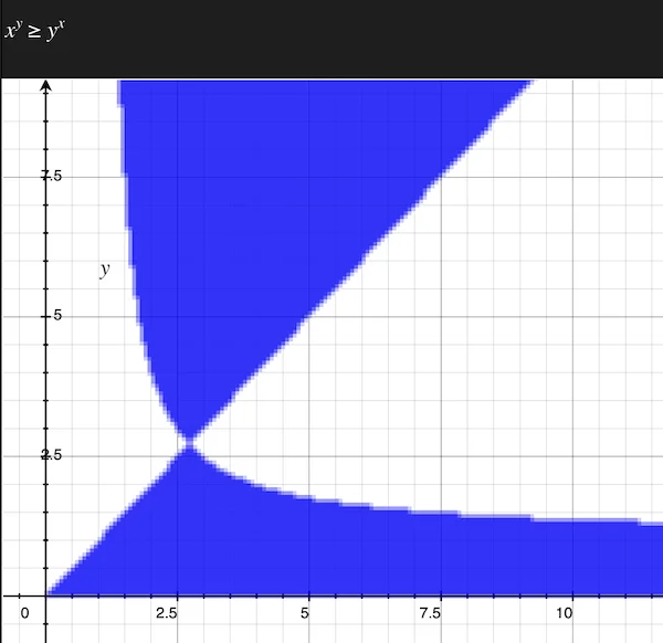

Apple's 'grapher' application also generates it.
Though, it appears to develop brain flatulence if the numbers get too large.

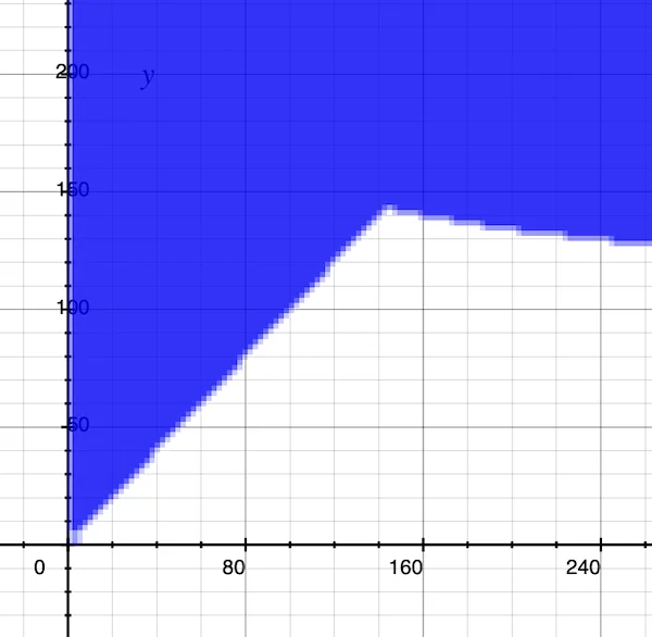

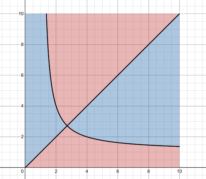

The aliasing is real. What is with the pixelated graph?
One can take the log of both side of the inequality and plot that. That plot looks identical but goes on exponentially further. The purple is blue overlapping red and boundary between blue and purple is where it’s failing due to large exponents.
Also, it’s obvious but if you look at the regions where a^b >b^a vs <, they are symmetric about the a=b axis so exactly half the quadrant is greater and half is lesser.
