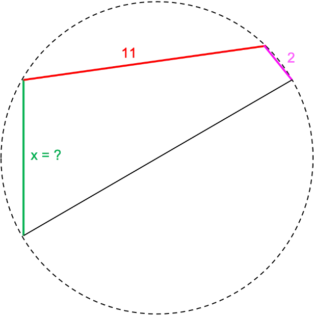

The problem is to find x. In the lower semi-circle they had one half of a regular hexagon with all 3 sides of length x, so that says immediately that x=r. In the upper semi-circle they had 3 sides of length 2, x , and 11. The problem is to find x. The correct answer is 7, but I'm looking for a simpler way to do it than the cumbersome way I presented with more detail in post 3.
I guess it's too much trouble for you to post a graphic of what you are talking about.
I am all thumbs with computer graphics. Hopefully the explanation is clear enough to follow. :)
The original problem was on-line on Facebook, but normally the share feature isn't allowed on PF.
Can you take a screenshot and copy it here?
Is this it?
  • Care
In the original problem, x is in between the 2 and the 11, but mathematically it makes no difference.

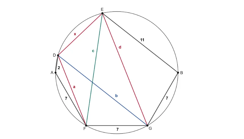

When I tested the central angles using 7 for the x and the radius,
it worked out, so there may be a subtle linkage.
So, given the picture, if x is a chord and x is the radius, we have an equilateral triangle, reducing the problem to a quadrilateral with three inscribed corners on the circle, where two of the sides are both radii as x. The angle between the two x's is 120 degrees.
and so then we can divide the quadrilateral into two triangles, where for triangle 2 we have an its central angle relationship: ##sin(2*\theta_2)=x## and ##sin(2*\theta_{11})=(11/2)x=##
and separately we have ##2*\theta_2 + 2*\theta_{11} = 120## which reduces to ## \theta_2 + \theta_{11} = 60##
Does that make sense?

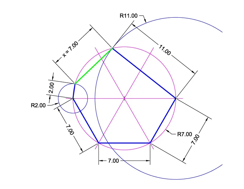

Graphically, x = 7.00

@Lnewqban very good,(post 13), but the largest circle with R=11 doesn't have its center on the other center. Perhaps I'm overlooking something.
I located the center of the R = 11.0 largest blue circle at the point I knew with certainty, which was the interception of the of the R = 2.0 smallest blue circle and the R = 7.0 magenta circumcircle connecting all the vertices of our polygon.

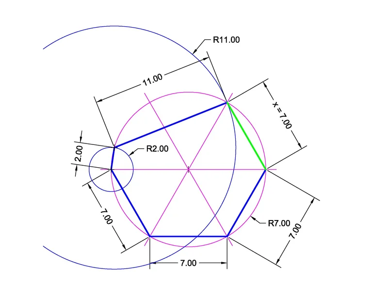

Using another point as center of the R = 11.0 largest blue circle:
@Lnewqban Very good graphics. Thank you. :)

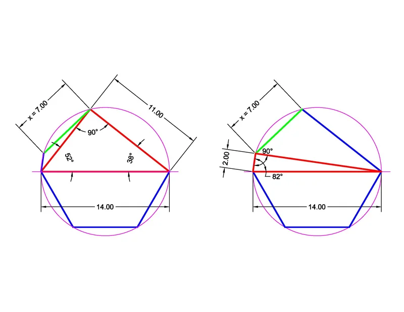

See
He has kind of a simple solution. Still no hidden symmetry, but he does have a good solution. His arithmetic is kind of simple, because he makes some good algebraic choices.

You are welcome, Charles.
Please, take a second look, right triangles are hidden in your diagram:
See the Thales' theorem in the following link:
https://www.mathsisfun.com/geometry/circle-theorems.html
:cool:
That's a great video description of the steps needed to solve the problem, and it eliminates the complex, difficult-to-reduce equations we encountered.
In some ways, it reminds me of the admonishment I received as a young undergrad trying to reduce a matrix to a simpler form, but ended up with complex fractions. The professor reminded us to subtract rows to achieve the magic 1 in a column, allowing us to reduce the matrix further.
In another case, the professor reminded us that integrating over y before x could produce a helpful answer, and he gave a quiz with that exact scenario.

@Lnewqban I didn't know the name of it, but Thales' theorem was one of a couple of things I was trying to apply to simplify things. It turns out though, the video has some very simple formulas to see the results. It is likely IMO that the authors of this problem may have begun with one side of 2, and tried a bunch of integers for the second side using the simple formulas of the video, and then found that 11 works with the final side and radius being a 7.
I am pleased with the solution that the video has. It makes things simple enough that we don't need mathematical coincidence to explain where the combination of 2, 7, 11 and came from. :)
Edit: He gets on the video, (with the first side = 2), that ## (11+1)^2=3(x^2-1) ##. It is sort of easy to see from this how they got the combination of 7 and 11, but I don't see any others that work besides the simple case of x=r=2 with the third side =2. This case of 2, 7 and 11 might just be a rare combination...and then I see x=26 gives 44 for the 3rd side. :) That would imply that the combination of 1,13, and 22 would also work, with x=r=13.

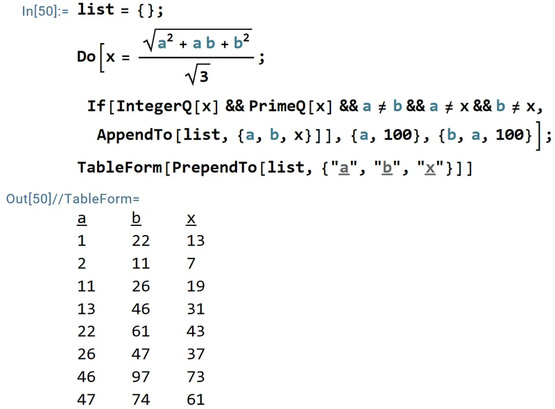

I've been trying to find others, but so far only 2,7, and 11 along with 1, 13, and 22 plus multiples thereof. The combinations that work seem to be very limited. Perhaps someone else can find one or two more. Hopefully I got the arithmetic right on the other one that I found. :)
Edit: I did find one more: 11,19, and 26 with ## x=r=19 ##. Hopefully I got the arithmetic right again. I will double-check that result. :) and I checked the angles on this last one=they do add up to 120 degrees.
Perhaps I should post a little detail on what I am solving. Following the video of post 18, I'm looking for integer solutions of ## (a+2b)^2=3(4x^2-a^2) ##, for integers ## a,b, ## and ## x ##. I start with an ## a ##, and then look for an ## x ## that gives the expression in parentheses the result of 3 times a perfect square. From that I then compute ## b ##.
It should be noted that ## x=a=b ## always works. This is the trivial solution of the regular hexagon.
and note, with the combinations I found ( 2 of them), I could make up my own version of the Olympiad problem. e.g. they could start with 11 and 26 and find the third side x with 19 as the answer. LOL

and I found a 4th one that works: 13,31, and 35 (correction =46 instead of 35) with ## x=r=31 ##. Like @jedishrfu said above,( post 23), it is likely these have been found previously and are well known, but it is fun to do my own exploring. :)
I also thought I had another with ## a=13 ##, and ## x=7 ##, but I found that ## b=-2 ## for that case.
Perhaps this is a very well known problem and someone can post a list of the known solutions. :)

If you search using the solution values it might identify a name and many additional values. There may even be some other use for them.
I took your suggestion, but no luck so far. I had more luck yesterday coming up with the video of post 18 with a search. I'll need to keep trying. :)
Using the law of cosines and reasonably simple algebra, I got the following expression for the radius-squared in terms of the given sides $$R^2=\frac{a^3-b^3}{3(a-b)}.$$I will post my derivaton in a few hours because it's very late where I am.
