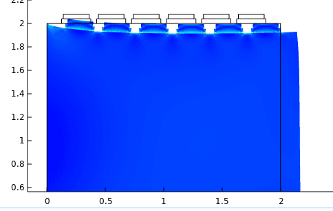

I have been experimenting in producing some strain to this object. However, after applying a prescribed displacement and setting it to a certain value, it does not exceed 2.18[um] no matter any extreme value for the prescribed displacement.
I have also experimented with an applied force as well and the result is still the same?
Is there any ideas why the object would not stretch as much? considering this is a very rubber like material that I have assigned.
Make sure that plots are refreshed after subsequent runs and that they use the correct data source (solution). Maybe create the plots from scratch.
