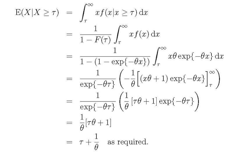

Given X follows an exponential distribution [tex]\theta[/tex]
how could i show something like
[tex]\operatorname{E}(X|X \geq \tau)=\tau+\frac 1 \theta[/tex]
i have get the idea of using Memorylessness property here,
but how can i combine the probability with the expectation?
thanks.

If you write down mathematically the Memorynessless property then it might become obvious. Otherwise it's fine to express the conditional expectation as a ratio of integrals and evaluate it directly.

[tex]\Pr(T > s + t\; |\; T > s) = \Pr(T > t) \;\; \hbox{for all}\ s, t \ge 0.[/tex]
i just can't convert from expectation to the probability...
damn
That's what I did so far.
But I just can't use the memoryless property to do it ...
http://img138.imageshack.us/img138/5945/tempz.jpg
  • Handwritten-style typeset derivation of E(X | X ≥ τ) for an exponential density, rewriting the integral with F(τ) = 1 − exp{−θτ} and concluding τ + 1/θ as required.
Hint: rewrite the memoryless property into a form suitable to use on line 1 of your proof. Conditional probabilities -> conditional cdf -> conditional pdf.
