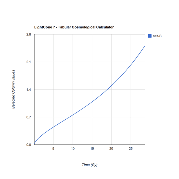

You're right! IF Hubble rate stayed constant, but it had been declining as a percentage growth rate.
Here's what I think is a good way to think of it. If you work out all the units (kilometers, seconds, megaparsecs) you find that according to current estimate of H(now), it corresponds to distances growing 1/144 of one percent per million years.
That's equivalent BTW to the "Hubble distance" (i.e. the size of a generic distance growing at speed of light) being 14.4 billion ly.
As long as the percentage growth rate is constant, or even gradually declining but only very slowly, we have exponential growth.
But the catch is for much of the expansion history of the universe the Hubble rate was declining so fast that the growth of a generic distance was actually DEcelerating!
And then in 1998 with some more precise measurements, that you know about, we discovered "HEY, the percentage growth rate is NOT DECLINING AS FAST as we thought and is actually going to level out at 1/173 % per million years! We are very gradually approaching an exponential growth pattern and there is this very slight acceleration!"
Here's a picture of the growth of a generic distance over time. You can see that the slope was clearly declining until around year 7 billion. Then it looks almost constant for a while as it begins very gradually to steepen. Acceleration started around year 7 billion, but so far has been almost imperceptibly gradual. We are now at year 13.8 billion--steepening becomes more visible on the graph around there.
This plot is what you get if you open Jorrie's calculator and do the following clicks:
click on "chart" and on "set sample chart range"
click "column definition" to get the menu and UNcheck everything except for Time and Scale factor.
click the white dot at the Time menu item, to make that the independent variable
press "calculate".
