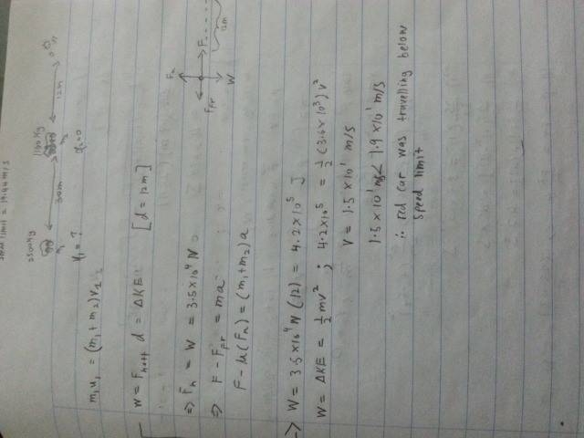

Solve:
1. Calculate the velocities of two vehicles before and after impact using physics principles, such as forces, motion, mechanical energy, and conservation of momentum.
2. Explain how frictional forces related to varying surfaces affect the motion of an object.
1)m1u1=(m1+u1)V1
2)W=Fnettd=[itex]\Delta[/itex]KE
From second equation:-
Fnett=mg=(3.5*10^4N)
W=W=Fnettd=(3.5*10^4N)(12m)=4.2*10^5 J
W=[itex]\Delta[/itex]KE=[itex]\frac{1}{2}[/itex]mv^2; 4.2*10^5 J=1/2(3.6*10^3)v^2
v= 1.5*10^1 m/s
thus the red car is traveling below the speed limit .
I did this question only until here as I was not sure of my answer.
Please point out errors and if not understood I attached an image.Thanks

You're image is very hard to read, so I may be misinterpreting.
It looks to me that you have calculated the work required to raise both vehicles vertically by 12m. There should be a reference to coefficient of friction. The text of the problem seemed to be leading up to a value for that but I don't see one. Have you left out some text?
Yiu are asked to explain your method to your superior. That would be a tood way to start your post, before getting into the algebra.
Also, when you do get into the algebra, always work symbolically, as though all the values are unknowns. Only plug in numbers at the end.

No reference of coefficient is given in this question :(

Then take the coefficient of kinetic friction to be an unknown μ. Create symbols for all the given data and see what equations you can develop.
Looks like you've got four unknowns, and it is possible to create 4 equations.
Well, I think you have left out some data. If you have the initial velocity of the car which is moving then you can easily calculate μ using v2 -u2 = 2as , F = ma and F = μN.

Given the context in which the question is set, the initial velocity is the value to be calculated.
And how do we get the initial velocity?
I think the best way to go about this question is to assume the standard coefficient of kinetic friction to be 0.7,from there you can calculate acceleration using F-Ffr = ma, from here use V2=U2 -2as to find U ,since the final velocity is 0 so V=0 . From here to find the initial velocity of the red car just use the same formula but change S=30 m and you will find that the red car exceeds the speed limit.
Yes, except that you have not described how to obtain the red car's speed just before the collision from its speed just after the collision.
How about you post some equations and working? (Please keep it as purely symbolic algebra, as though you had no numerical values.)
