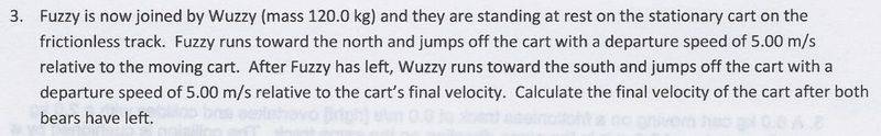

Conservation of Momentum and Relative Velocity Problem
The problem involves the conservation of momentum in a system where a larger mass splits into two smaller masses. The scenario includes a cart and a character named Fuzzy, with specific masses given for each. The participants are exploring the implications of momentum conservation during the events of Fuzzy jumping off the cart.

mass of Fuzzy = 100.0kg
mass of cart = 200.0kg
Conservation of Momentum for 1D Motion
Relative Velocity for 1D Motion

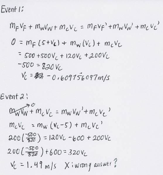

Since everything is at rest at the beginning, the total momentum of the system is 0. So at the end, 0 = m1v1 + m2v2 --> m1v1 = -m2v2, so m1v1 = -m(5+v1), and after expanding that, and solving for v1, the answer isn't correct. The correct answer is 0.685m/s [N]. IS my approach wrong? I think it might be do to a change in the mass of the system, but even if that is the right way to go, I don't know how to incorporate that in the equation.

k I did my work, but I still got the wrong answer. I'll scan my work.
I still end up with the wrong answer. The correct answer is 0.685m/s.
You're complicating this TOO much. Initially there is ONE object of mass Mtot = mw + mf + mc
After event 1, there are TWO objects, one of mass mf, and one of mass M = mw + mc. So, conservation of momentum says:
0 = mfvf + Mv
where v is what I'm calling the velocity of (cart + Wuzzy) after Fuzzy jumps off.
mfvf = -Mv
Now, let's arbitrarily choose North as the positive direction. We are told that Fuzzy moves at speed +5 m/s relative to M, or in other words,
vf - v = 5 m/s
vf = (5 m/s) + v
substituting, we get:
(5 m/s)mf + mfv = -Mv
mfv +Mv = -(5 m/s)mf
(mf + M)v = -(5 m/s)mf
v = - [ (5 m/s)mf ] / [mf + M]
DON'T PLUG IN ANY NUMBERS YET. What would be the point? It would just introduce needless intermediate arithmetic steps. Keep things algebraic until you have the expression that will allow you compute the final answer.
For event 2, we initially have one object of mass M moving with velocity v. After the collision, we have two objects of mass mc and mw. Conservation of momentum says that:
Mv = mwvw + mcvc
Now, we are told that Wuzzy is moving at a velocity of -5 m/s relative to the cart. In other words:
vw - vc = -5 m/s
vw = vc - 5 m/s
Substituting this into the consv. of momentum equation:
Mv = mw(vc - 5 m/s) + mcvc
Mv = mwvc -mw(5m/s) + mcvc
Mv + mw(5m/s) = vc(mw + mc)
vc = [Mv + mw(5 m/s)] / (mw + mc)
Now, substituting in the expression for v, this becomes:
[tex]v_c = \frac{(-5m_fM)/(m_f + M) + 5m_w}{m_w + m_c}[/tex]
NOW plug in the values. If I do this, keeping in mind that M = mc + mw, I get +0.6845 m/s.
I encourage you to scrutinize every step of this solution, and if there's something you don't understand, ask me about it. The physics of the problem is easy. It is merely algebraically messy.
After reading only the first two lines, I redid it and got the right answer! Thanks for your help!
