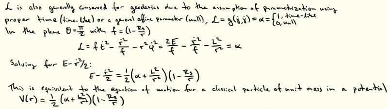

Interesting. So I get $$ \frac{r^3 \left(\dot r^2-E^2\right)-2 L^2 M+L^2 r}{r^2 (r-2 M)}=-1 $$ I could solve that for ##\dot r## to get a first-order differential equation that seems useful. Otherwise, even with the conserved quantities, the original Euler equations gives me a second-order differential equation for ##r##.
This is from my GR lecture notes:
In essence, you find the Newtonian equation of motion with time replaced by proper time and the additional term caused by ##\alpha## (your ##Q##, essentially a constant term) and the additional term caused by the cross term of the angular momentum barrier with the Newtonian potential.
Edit: Note that I also defined ##E## differently ...
This choice is obviously just to reproduce the similarity to the Newtonian equation.
Edit 2: You should find the same if you replace ##E^2 \to 2E## and solve for ##\dot r^2/2##.
