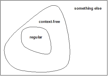

To show that S-L is context-free,could I also show that each regular language is context-free and that the set of all regular languages is a subset of the set of the context-free languages?So,the difference is only the set of the context-free languages.Or am I wrong?
Please describe the logic of this argument in greater detail. That is, suppose that we know that regular languages are context-free. How do we use this fact to prove that S - L is context-free?
From the image:
we see that the set of the regular languages is a proper subset of the set of the context-free languages.So,if we subtract the regular language from the context-free one,the set that remains is context-free.Can I say it like that?
This is true.
And this is a completely different thing. The first quote talks about the difference between the set of context-free languages and the set of regular languages, and the second quote talks about the difference between an individual context-free language and an individual regular language.
This is true.
I understand...Thanks a lot! :)
