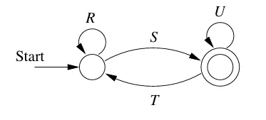

How to show R*S(U+TR*S)* is equivalent to (R+SU*T)SU* using regular expression algebra?
I was studying the given finite automata. Using $$R_{ij}^{(k)}$$ method, I found out that the Regular Expression that this automaton accepts is $$R^*S(U+TR^*S)^*$$. But my book says, the regular expression for the accepted strings can be described
in various ways. One is $$(R+SU^*T)SU^*$$.
How do I show that these two regular expressions are equivalent?
I don't know, but I am having difficulty seeing how ##(R+SU^*T)SU^*## can really be a correct expression? I mean consider any string accepted by the automaton you posted such that it contains at least 2 or more ##R##'s. For example, consider the string ##RRS##. It is accepted by the automaton but I can't see how it can be generated by the expression ##(R+SU^*T)SU^*## ?
I think the OP must have a typo in the second expression, missing a repeat.

Neither of the regular expressions you post correctly describe the diagram: @SSequence has posted a string that is incorrectly rejected by the second expression (R+SU*T)SU* and the string STS is incorrectly rejected by the first expression.

You keep posting the same obviously incorrect expression. And you keep posting it using ##LaTeX## math notation which is completely inappropriate.
The expression is obviously incorrect because the first node of the diagram
PLAGUE said:
is clearly R* not R+.

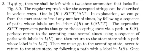

Studying from what source? Please provide a reference.
(R+SU*T)*SU* incorrectly rejects STS. Perhaps you intended to post (R*SU*T)*SU*?
Note that as I posted in #5 the string STS is also incorrectly rejected by your first expression R*S(U+TR*S)* due to a similar error - U+ in this expression should be U* if it is to correctly encode the diagram. Do you understand the difference between the Kleene Star * and the Kleene Plus +?
I ask you again, what is the source for this material?

Comparing with the diagram, I read use of symbol + in any of OP posts to really indicate RE alternation and not Kleene plus, that is, (R|SU*T)SU* with the normal operator precedence.

So, to paraphrase the OP with the corrected second expression, the question is:
How can I prove the equivalence of ##R^*S(U+TR^*S)^*## and ##(R+SU^*T)^*SU^*##?
Well by definition two REs are equivalent if they describe the same FA so here this is trivial. Another way of proving equivalence is by transforming the REs to a common form using equivalences such as ## (a + b)^* = a^* (ba^*)^* ##. @PLAGUE is this what you are trying to do? Please show your efforts so far.
https://en.wikipedia.org/wiki/Introduction_to_Automata_Theory,_Languages,_and_Computation
Edition 3rd page 99

+ means or here. You may be familiar with |

There are three ways to do this:
  1. show that that they are both implemented by the same automaton - which is tautologically true here
  2. test with all possible strings in the language
  3. algebraic transformation - you will learn about this in section 3.4
For now, I would stick with the tautology.
