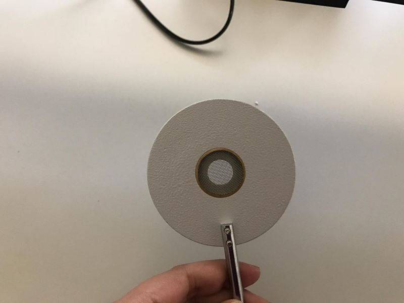

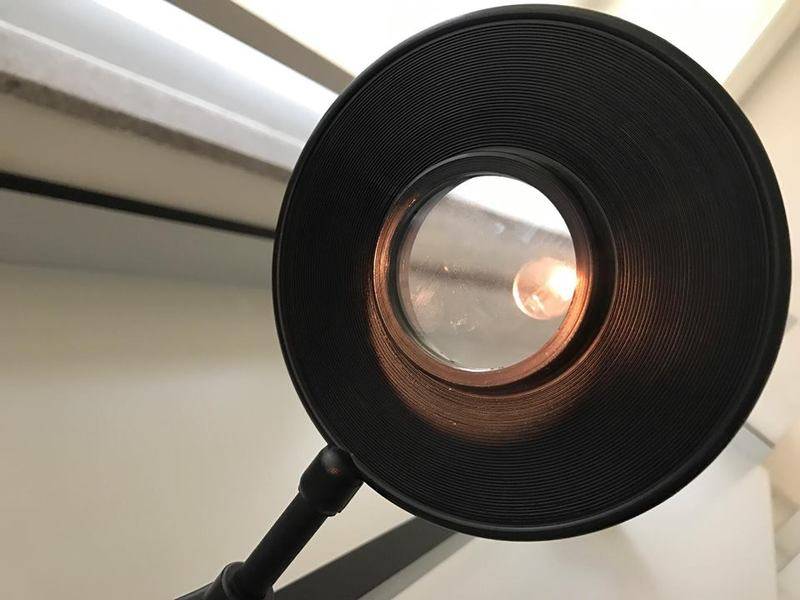

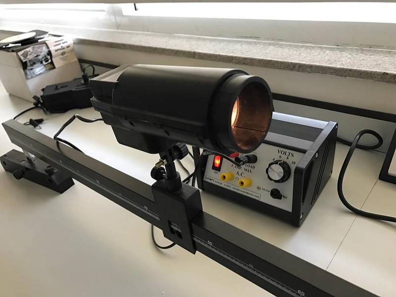

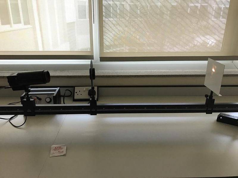

I set up the experiment as shown in the pictures. I placed the object grid in front of the light source, followed by a plano convex lens (f=30 cm) followed by the screen. The problem with the object grid, I don't see an image of the object grid but of an inverted filament instead (not clear in the diagram). I then removed the object grid and I still saw an inverted image of the filament. Why am I not seeing the object grid? Everything is aligned. I only see the object grid very clearly when it's really close to the source after that it disappears and a very clear image of the filament appears.

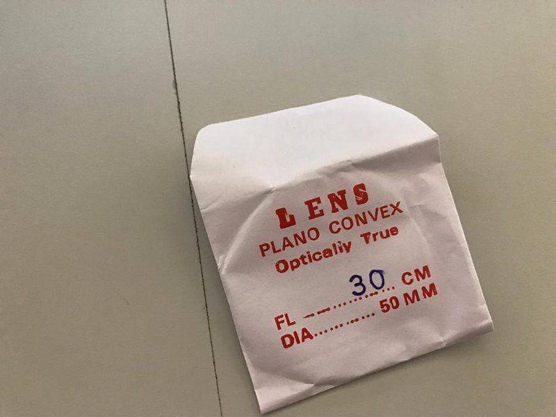

Another issue is that when I measure the object distance on the meter ruler and and subtract it from the image distance which I also read from the meter ruler, I don't get the focal length actually mentioned on the lens pack. The focal length on the pack is 30 cm and I get a difference of 85 +/- 5.
  • Optical bench setup: a light source with a filament on the left, a converging lens mounted on a holder in the middle, and a white screen on the right, all aligned on a metal rail in front of a window.

  • Paper envelope labelled LENS, PLANO CONVEX, Optically True, with handwritten FL 30 CM and DIA 50 MM.
Try placing the object grid as close to the light source as you can; the grid is your object, and the source creates the rays you are trying to direct into your lens.

Thanks for your reply. I tried doing that too, as I moved the lens further away, the object grid would turn into this blur circle of light and then suddenly, after further movement, a very clear, inverted image of the filament would show up. Quite strange.

Try this:
Position the lens where you get
Taniaz said:
...a very clear, inverted image of the filament...
Now move the light farther away from the lens and put the grid where the light used to be.
Ok I'll try that but why can't I seem to get it with the light source present?
