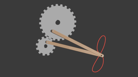

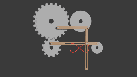

Two methods I came up with from tracing out figure 8s. The first produces a somewhat uneven one as is, but you can slightly adjust the shape by fiddling with the lengths of the Arms at bit, and might get something better.
The second method produces a more symmetrical path. It's overall shape can be varied by where you put the pivot points for the rods on the gears.

Nice. The second one is essentially the Lissajous figure approach I suggested, I think. Though you've obviously thought it tgrough in more detail. :smile:
Are those diagrams done in Blender?
Yes, done with Blender.

I think I can see how to do all of it with simple animation and "copy x/y coordinate" constraints except for the red path. Is that manually calculated, or did you get Blender to generate it somehow?
(Sorry for the digression, OP. I'll stop hijacking after this post.)

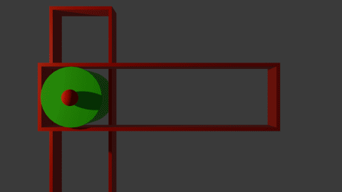

The top one was done using armatures, which act like a chain of bones, in this case, 2 bones. The base of the chain is parented to the smaller gear so it follows it as it rotates. the other end of the chain is parented to an "empty" (essentially an invisible placeholder for an object). and that empty is parented to the larger gear. This last bit involves Inverse kinematics, which causes the chain of bones to react to the motion of the empty without having to animate each bone separately.
With the second, each arm is parented to its respective gear and given constraints to limit their rotation so they maintain a fixed orientation. And while I could have used drivers to mathematically control how the peg in the slots moved, I opted for a more "brute force" approach where I simply manually positioned it every 3 frames and added a keyframe. The red lines used a similar brute force approach, where I added a "path curve" and manually adjusted it to follow the path of the peg, then converted it to a tube to give it some thickness.
Thanks, @Janus. So it's not fully using Blender as a physics engine, but it's automated enough that the motion of the pen is computed. So even if you've done some manual drawing, it's based off (and consistent with) the automated bits.

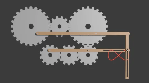

I think there'd be a practical problem with the orthogonal arrangement. When the horizontal bars are at the 3 o'clock/9o'clock position, they exert no driving force on the wheels at the right. The bars would not remain horizontal. This could be fixed by adding gear trains to drive the right hand wheels from the gears independently of the bars.
Since the original animation was just to show the basic idea, I didn't include those types of restraints as it would be simple to do something like this instead to keep the bars oriented.

Of course, now you inspired me to do a more physics engine driven example. In this animation, the boxes actually constrain the cylinder using rigid body physic, then the path is traced out using geometry nodes. I didn't do a figure eight, but just basically gave the boxes some random motions, and let everything else naturally follow.
As a consequence, there is a little bit of "wiggle" in the line since there is some slop between cylinder and boxes.
