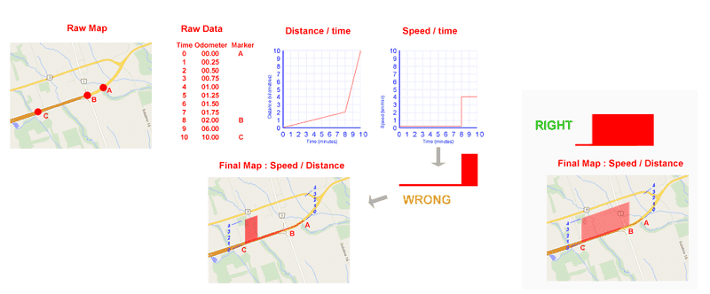

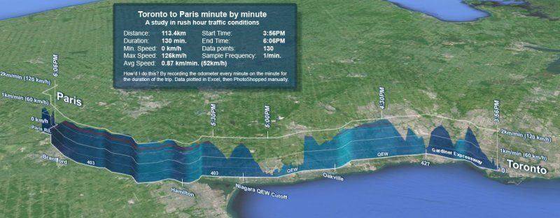

Trying to figure out how to get the curve I want, to plot on a map.
This was my first iteration:
It's wrong.The following sample will illuminate why. For illustration, the sample is much smaller and far more idealized than my real dataset, which is 100+ datapoints.
In my idealized trip, I've driven a course 10km long and taken odometer readings every minute.
(The course is 2 km on a back road, followed by 8km on a highway. The 2km on the back road took me 8 minutes, while the 8km by highway took me only 2 minutes.)
So, I dump all these odometer readings into Excel, and it allows me to produce the Distance / Time graph, but I can also produce the Speed / Time graph.
I took speed the graph itself and superimposed it onto the map, twisting it to match the course.
You can see that is is completely wrong. The leg of the journey from B to C,where I am travellnig at 4km/minute is 4/5ths of the entire course, but the overlay indicates that it is only 1/5th.
I know why it's wrong, what I'm trying figure out is how can I transform the datapoints in Excel so that the speed graph is correct. I'm thinking I have to change the cell formulae to calculate speed per cumulative distance travelled? I'm not sure.

So you want to plot speed vs. distance.
Your speed can be calculated by
[tex]s_n=\frac{d_n-d_{n-1}}{t_n-t_{n-1}}[/tex]
but since your data is in increments of 1 minute each, your speed (in units km/min) at a particular point is just the cumulative distance at that time minus the cumulative distance traveled at the minute before.
So if you have the time 0-10 in cells A2-A12 and distance markers in cells B2-B12, then just create a speed column in cells C2-C12 where cell C2 is 0 and cell C3 has the value =(B3-B2)/(A3-A2) or simply =B3-B2 because of what I explained earlier, and then just drag down from there to fill all the cells.
The problem I've ran into now is that excel by default skews the x-axis so that only the distance positions you've entered are shown. This means that most of your graph is distance 0-2 while the end jumps to 6 and 10. I don't use excel so I'm honestly not sure how to fix this.

$A is odometer reading
$C is $An-$An-1
$D is $Cn-$An-1.
[EDIT] Wait a minute. The X-axis shouldn't be time, it should be distance.
Don't know how to do that in Excel.
[MOAR EDIT] Oh. Scatter plot. I think

So again you want to plot speed on the y-axis versus cumulative distance on the x-axis. The speed is calculated by your C column, so all you have to do is then plot your C column against your A column. But hopefully you can bypass the problem I've had where the x-axis spaces each odometer reading evenly, even though the readings themselves aren't linear, hence skewing the graph.
Also, that D column is meaningless.
Yes, it's the figuring out how to plot a column of numbers on the X-axis that's tricky. Excel doesn't like to do that.
I think the answer is to abandon line/area graph and go to scatterplot, where you are providing both a Y and an X value for any given coordinate.
Yes that seems to do it!
It's ugly and likely unreasonable, but you could get the area graph to work correctly if you tabulate every odometer increment. So you'd have 0-2 with 0.25 increments with speed 0.25, and then 2-10 with again 0.25 increments with speed 4. It would add a lot of extra data and make things ugly though, so I think the XY scatter plot is the best choice here.

So does the XY scatterplot do the trick for you? I tried one of the line graphs of that type and it seemed to curve up and around (above speed = 4), which I guess is an attempt to smooth out the edges.

Turn off the smoothing option.
I'm trying the scatterplot now. At first blush, it does the trick. Now I'm plotting it on the map, and trying to see if it really does line up better than my original attempt.

It definitely lines up nicely.
