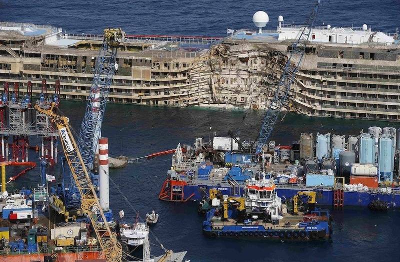

More Costa Concordia Parbuckling Hi-Res Pictures
Next up is the preparation for attaching the starboard sponsons. From the looks of it, the starboard side looks pretty good except for one area. Looks like they'll have their work cut out for them on that section.
Correction: Other pictures in the Hi-Res link above show a similar, smaller dent near the rear. All of the angles are bad so it's hard to say how bad that area is.

What's all those vertical silo-like tanks on the barge in the photo up in this thread?
Bottom right of the photo.
That ship is the ASV Pioneer. It is a support ship that is housing salvage personnel and equipment. The tanks are for various purposes such as http://ferguson-group.com/ferguson-asv/product-info/asv-pioneer/.

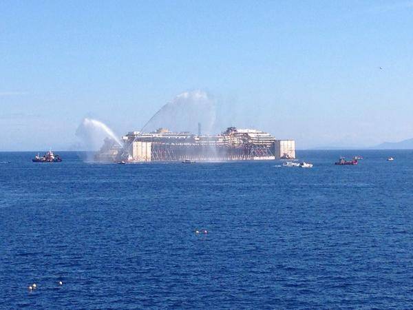

A final goodbye.
