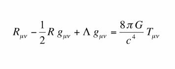

In the paradigmatic LambdaCDM a.k.a. ΛCDM model of cosmology, "dark energy" is described in terms of the cosmological constant, Λ, of general relativity, which is part of the equations of general relativity that usually appears on the left hand side of Einstein's field equations shown below:
In Einstein's field equations, above, the Lambda term (Λ) which stands for the cosmological constant, is immediately to the left of the equals sign, and is part of what are basically the force equations for gravity in general relativity. The cosmological constant Λ is a single, dimensionful number (without an imaginary number component) which has a measured value on the order of 10−52 per meter squared.
So, what you are suggesting is, in one sense, the status quo.
The language we use is inconsistent. We conventionally put the cosmological constant on the "force" side of Einstein's field equations, even though we call the effects it gives rise to "dark energy" which implies something that would be on the "stuff" side on the right hand side of Einstein's field equations.
But these conventions are based on little more than what "looks pretty" in the equation, and what "sounds nice" when we say it aloud. Sometimes it is more useful, intuitively, to think of the cosmological constant as part of Einstein's field equations. Sometimes is is more useful, intuitively, to think of the cosmological constant as "stuff" that is spread evenly throughout the universe.
Of course, equations are just equations and only have the labels we attach to them. You can call the cosmological constant part of a "force equation" but you could also call it part of the distribution of "stress-energy" to which Einstein's field equations are applied and hence part of "stuff" rather than a "force".
It is trivial, with simple algebra, to show that we can move the cosmological constant term from the left hand side of Einstein's field equations, which we conceptually think of as the "force formula" that tells us how stuff on the right hand side gives rise to gravitational effects, to the right hand side, which we conceptually think of as "stuff" that causes gravitational effects. Both versions are correct. These are just different ways of presenting the same equations. So, ultimately, the question of whether "dark energy" is a force or is "stuff" is an arbitrary distinction in the current paradigm.
"Dark energy" gets its name because the cosmological constant, Λ, in the equation above, is physically equivalent to a field of energy, with a constant amount of energy per volume of space, everywhere in the light cone of the Big Bang. If you wanted to, you could replace the cosmological constant term with a slight, almost infinitesimal, increase to the T00 element of the stress-energy tensor shown below, everywhere.

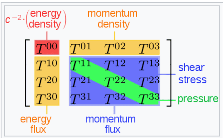

As an aside, the mass-energy of "dark matter", "ordinary matter", and photons, as well as linear momentum, angular momentum, "shear stress", and pressure (which can be thought of as different kinds of energy), are all "inside" the term Tμν, in the Einstein's field equations. This term is called the stress-energy tensor. The stress-energy tensor is a four by four matrix, conventionally arranged as follows (image from the link), although there is nothing sacred about that arrangement:
