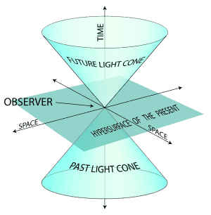

If by "light cone" you mean the ones you find in diagrams like these:
Then they work perfectly fine with straight edges, as the slope of the line represents the maximum distance you can travel per unit of time. Generally these are shown as emerging from a single point, which represents a single event in space-time. Also note that this diagram is only applicable in nearly flat spacetime (or so I think). See more below.

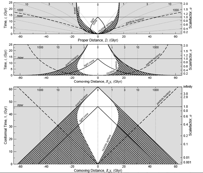

Have a look at these lightcone graphs from the oft-quoted Davis & Lineweaver paper
As you can see, the nice straight lines of light paths do curve back in an expanding universe. The top graph has the most layman-intuitive coordinates, where distance and time are what we normally think of them to be.
If you don't know what comoving coordinates mean, just ignore the latter two. It is worth keeping in mind, however, that all three represent the same thing.
The graphs below (made by yukterez, who's a member on PF) are analogous to the top two, but animated:
http://yukterez.net/lcdm/lcdm-flrw-animation.gif
If it's not clear, the lightcones show all the light that reaches the observer at their apex. So, you can trace the path of light an say when and where the emission events of all the light that we now observe were. E.g., it can be seen that of all the light we receive now, the emission events that were the farthest away in terms of proper distance happened about 8 Gy ago (where the 'teardrop' shape of the lightcone curves around), and that these events were approx. 5 Gly away. All the earlier (below that point) and later (above) emission events were closer.

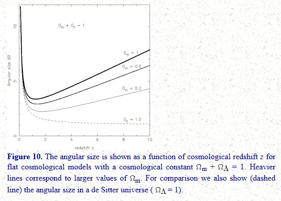

But there is a magnification effect at high z, isn't there?
https://ned.ipac.caltech.edu/level5/March02/Sahni/Sahni4_5.html
In particular this graph shows it well:
That is, as the OP guessed, you do get increase in angular diameter of faraway objects, (edit:although that is an effect specific to universes where deceleration switches to acceleration at some point in history (i.e., universes with matter and dark energy)).

That really depends upon what you mean by magnification.
First, I don't think that this effect has anything to do with the acceleration of the expansion. I'm pretty sure it will happen in any universe where the rate of expansion decreases sufficiently. That is, if we had no dark energy, I'm pretty sure we'd see this effect. Only if the universe had always been dominated by dark energy might it not be significant.
That said, yes, the angular size of galaxies of the same intrinsic size decreases for a while, then starts increasing again at very large distances. I guess I don't see this as magnification per se because it's still not a matter of light being deflected as with a lens: it's due to the fact that the universe at the time was smaller, but we're considering an object of the same intrinsic size. The apparent size is (very roughly) the size of the object divided by the size of the universe at that time. So same object + smaller universe = bigger apparent size (more formally it's an angle derived from the ratio of the size of the object to the distance between us and the object at the time the light was emitted: because the denominator of that fraction decreases at early times, the apparent size increases).
Yes, you're right. I'm not sure where that came from. Even the graph I posted includes a line for matter-only universe, so a purely decelerating one. I'll correct the post promptly.
