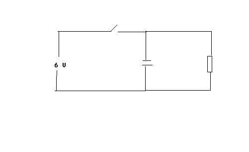

Can you post a diagram of your circiut?
I have attach the diagram of the circuit please help me .
  • Circuit schematic: a 6 V battery in the left branch, a switch in the top wire, a capacitor in the middle branch and a resistor in the right branch, all connected in parallel.
Where in the circuit are the ammeters?

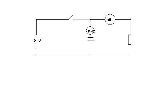

I am sorry I forgot t draw the miliammeter . I am now attaching the newer image of the circuit . As I said the miliammeter is always reading bigger than 1 mA eventhough the other miliammeter(mA2 in the circuit )is already 0 mA.Please help me.

Integral are you there ? Why you don't answer my question .Somebody please answer my question
I don't understand what this experiment is trying to do. The moment you close the switch on the uncharged capacitor, all the current will initially go through the capacitor, it would be like connecting wire between two ends of your power source. What will this achieve?
What is this experiment's aim?

To do the experiment you have described you will need an Ammeter as shown in my attachment. Please confirm the values of your circuit components including correct units. Actual measurements of the voltage and resistance would be nice.

But my book doesn't show the diagram as your attachment . Actually my experiment is used to calculate the time constant and only has one miliammeter(mA in the diagram I have attached ) and don't have the mA2.This was totally different from your diagram . Is it my book wrong .
If your milliameter is reading more than 0.9 mA, then either
1) your voltage source has more that 6V potential difference
2) your resistor has less than 6600 Ohm resistance (even with the meter)
3) your mA meter is slightly out-of-calibration,
. . . maybe even all 3.
Check the source's Voltage ... especially if it a battery!
Check your meter's reading with nothing connected.
Check your resistance with an Ohm-meter.
This is a relative measurement anyway ...
don't get hung up on 10% difference from "lab instructions" values !

lifesfun is correct since before I connect the capacitor it shows 0.9mA with resistance 6600 ohm . So, the resistance and the voltage should be no problem but as I mentioned , I don't know why the current increase to more than 1 mA when I connect a capacitor parallel to the resistance .
can anyone please answer my question.I know that the current increase is due to the internal resistance of the capacitor but I let the capacitor to fully charge and I think that after fully charge the current will back to 0.9mA but it is not the case , the ampere doesn't change even 0.1mA.Please help me !
Maybe (just a thought). If you are using a battery for this emf, it is a chemistry problem. An ammeter's resistance is very low, and so dragging the overall resistance of your circuit to a low value while the capacitor is charging. If this value reaches much less than the internal resistance of your battery; a lot of power will be lost in the battery as heat.
