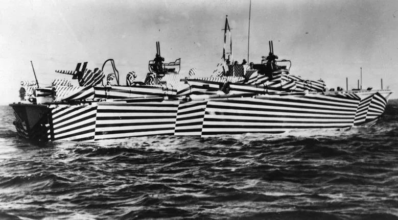

Before going further, you should know that dazzle camouflage has been around since zebras began roaming and by people for at least a century. Here's a British warship - probably WW1.

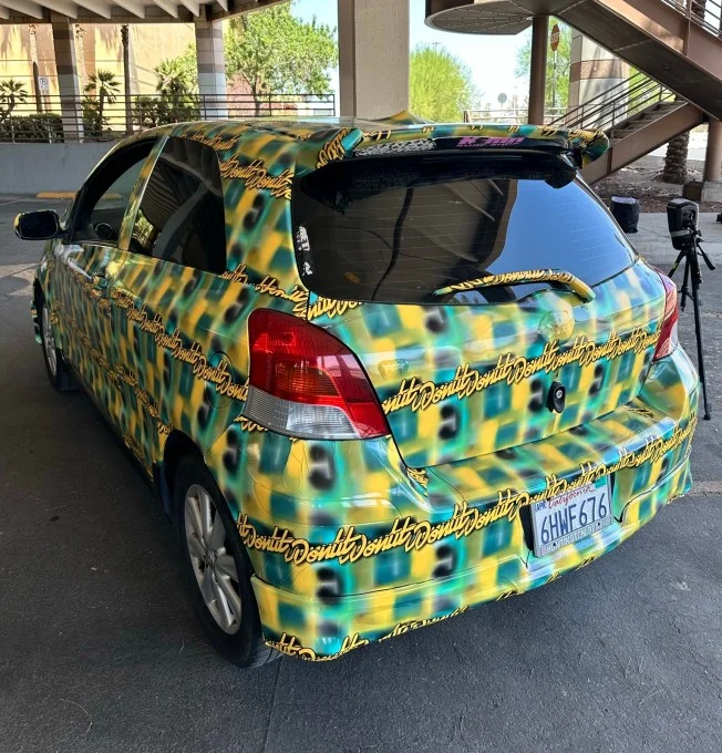

Automakers currently use it when road testing new designs - like this Jaguar:
You may be wondering what the point of this "camouflage" is. Certainly, if you saw that first thing floating in the North Atlantic, you would see it as a some kind of ship. And that car is most certainly a car. But it is more difficult to tell precisely which direction that ship is heading or exactly what new style points have been added to the Jaguar.

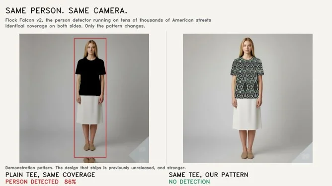

Here's one of Bills photo pairs:
In human terms, it's perhaps a fashion statement. In AI terms, she isn't there.

Quoting the TechCrunch article, he describes how these patterns were developed:
His proof of concept evolved over time into a reinforcement learning model, essentially a self-contained system that could train itself on which patterns work and which do not against the specific camera algorithms he is testing. In simple terms, Swearingen told TechCrunch that he essentially taught his model “how to paint.”
Each time a pattern failed and an algorithm detected it, the model would try again, over and over, until it eventually defeated multiple algorithms at once.
His model soon began to find perfect recipes for patterns that were able to defeat all of the 11 open source detection algorithms he tested, including the software that powers Flock license plate readers, Axon body-worn cameras, and cameras running Clearview AI.
I do not doubt that systems like Flock will eventually do better. Those systems are currently relying on short-cuts, small "tip offs" that happen to be commonly found with pedestrians, faces, or traffic. As evidenced by Bill's work, they are not looking at the "conclusive" evidence - most certainly because that would require 3d modelling and perhaps tracking objects from frame-to-frame - or with methods based on "people-are" as "people-do".
