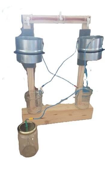

So to charge it, I'm trying to build a Kelvin Water Dropper. After 2 weeks of trying, and it being due on Monday, I can only come on here and hope some bright minds can help me troubleshoot it 😉.

Here is the annoying machine :
Photo of a homemade Kelvin water dropper apparatus: two metal cans on wooden posts with a plastic tube linking the top, blue wires running to glass jars on a wooden base, and a jar with a metal lid and green wire in front.
I'll just detail certain parts that I'm sure you're going to comment about !
* The inductors aren't touching the wood, there's some insulating foam (about $7mm$ in width once squished)
* The water stream breaks into droplets at about half of the inductor
* The jars in the bottom are glass, so insulating, and inside there are some copper coils.
* The 2 opposite-charge wires are fairly spaced (about $3cm$)
And when the water is flowing, no charge builds up, as the electroscope (the jar at the front of the photo), doesn't show any evidence whatsoever of charge on that system...
The electroscope works, attaching a coil to it and waving a previously-rubbed piece of polystyrene does make the aluminium flaps repel.
Also, I read humidity could be a problem, so I gave one system a little initial "boost" using the piece of polystyrene, to attract certain ions (not quite sure about the charge of polystyrene...).
I've tried using the electroscope and this charged polystyrene in a "circuit" to see if charges were leaving.
I found out :
1. if I wave the polystyrene on the coil attached directly to the electroscope, it works
2. if I wave the polystyrene next to the inductor connected to the electroscope, but not the empty containers, it works, but only if the electroscope coil isn't connected (I'm guessing the coil is doing the opposite job, giving up its charges to the air)
3. if I do wave the polystyrene in any of those 2 positions, but with the coil-activated containers connected, nothing happens (again, probably because the coil is inducing the air)
4. the 3rd test doesn't work either if the containers are full of regular (so, non-ionized) water
Do you have any ideas what I could be missing ?
The YouTube videos about this machine seem so simple, and yet, I'm still spending too much time on this thing...
Test the insulation. Disconnect the wires. Charge a balloon by rubbing it against hair or wool. Connect the electroscope to inductor 1, and try to charge the inductor with the charged balloon. If the electroscope leafs do not rise, the inductor is not properly insulated. Do the same insulation test with inductor 2, the copper electrode in jar 1, and the copper electrode in jar 2.

Hi, thanks for your answer.
As I already explained in the post, the electroscope leafs do rise, but only if the containers aren't connected. I'm guessing that because of the coils in the containers, am I right ?
Also, it should work if the coils are submerged right ?
I do realise charges are escaping somewhere, but I'm not sure where...

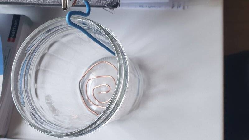

Photo of a glass jar viewed from above, with a blue plastic-coated wire hooked over its rim and a copper wire coiled in a spiral inside the jar.

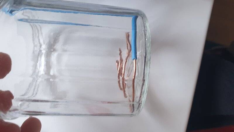

Photo of a clear glass jar with a copper wire coil inside, wrapped around the inner wall and attached to a blue-insulated lead wire running down the rim.
These are the coils in the container jars I am talking about.

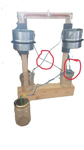

Hi,

I would check the marked possible electrons' paths or high voltage short circuits.

Thanks for those links, I did have a look.
And for the photo you annotated, no the cables weren't touching at all, they were about 5 cm apart, and the blue coating was quite thick.
Turns out it was charging a little bit, as I used a voltmeter and saw the voltage rise to about 36 mV, and then dropping back down and continuing on this cycle.
I'm pretty sure it was due to humidity, and as spring and summer are arriving, I'll try again.
