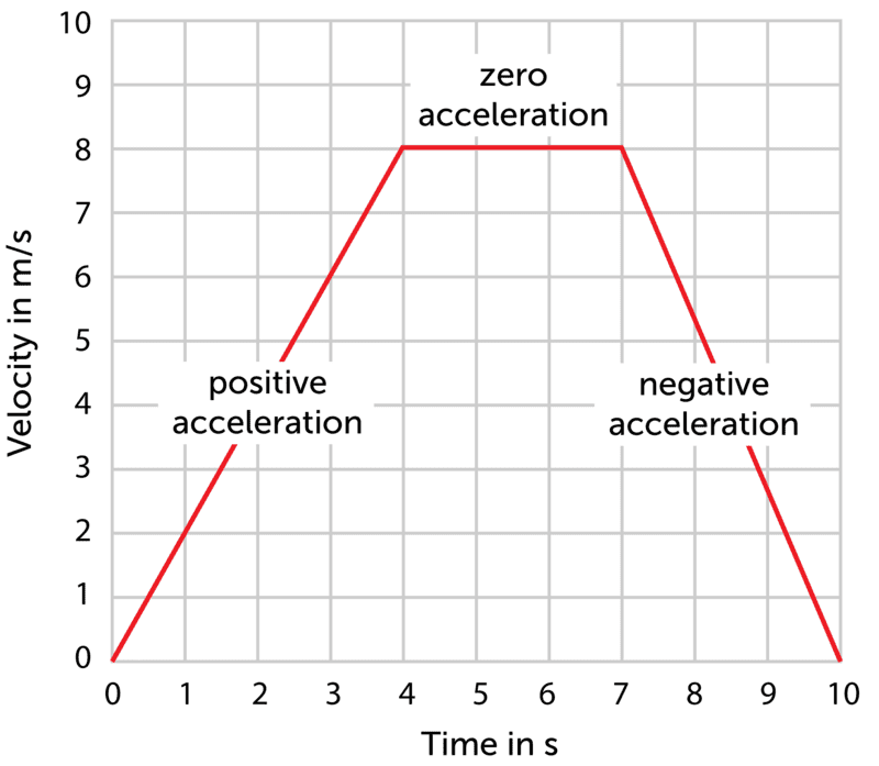

Have you been able to understand the question to the point of being confident with your use of that equation?
Again, if you make a graph of velocity versus time, you could easily see the whole process and the details of each of the three stages.
The area between the curve and the time-axis always equals the total distance covered by the vehicle.
Stage 1:
The first term of the equation becomes zero, because the vehicle accelerated from repose.
Stage 2:
The second term of the equation becomes zero, because the vehicle had no acceleration.
Stage 3:
The first term of the equation would be the distance to be covered if sustaining the speed of 40 m/s for the duration time of this stage 3, which must be reduced by subtracting the second term from it, because the vehicle is on negative acceleration down to repose.
This stage is the reverse of stage 1, but with a smaller rate of acceleration (negative in this case).

Is you graph correct as it stayed at 40m/s for 10seconds
