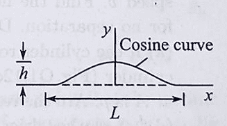

Designing a speed bump given the maximum vertical wheel acceleration

With the given information , we can find ##y=h\cos\frac{\pi x}{L}##
Since , the wheel has constant velocity ##v## , we can write the $$\vec{a}=0\hat{e_t}+\frac{v^2}{\rho+r}\hat{e_n}$$
where $$\rho=\frac{\left[1+\frac{h^2 \pi^2}{L^2}\sin\frac{\pi x}{L}^2\right]^{\frac{3}{2}}}{\mid \frac{h\pi^2}{L^2}\cos\frac{\pi x}{L}\mid}$$
So , we are given : $$\frac{v^2}{\rho+r}<ng$$ but i am stuck here . How do i simplify? Morever it seems like i might get a lower bound on ##h## rather than an upper bound

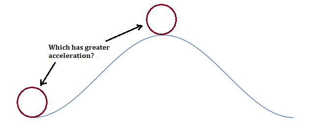

Consider the acceleration as the wheel arrives at the bump. Compare this to the acceleration when the wheel is at the top. Are they the same?

The acceleration of the center of the wheel at an arbitrary point ##p## of the bump is ##a = \dfrac {v^2}{R}## where ##R## is the radius of curvature of the trajectory of the center of the wheel when the wheel is at point ##p##. Thus, the maximum acceleration of the center of the wheel occurs at the point of the bump where ##R## is minimum.
Yes, ##R = \rho + r## is correct if the wheel is on the convex side of the cosine curve (such as when the wheel is near the top of the bump). For Charles Link's bump, however, the wheel is on the concave side of the cosine curve as it starts rolling up the bump. At the inflection point of the cosine curve, the wheel transitions to the convex side.
When the wheel is on the concave side, ##R \neq \rho +r##. What is the correct relation?
At what point(s) of the ramp does ##R## have its minimum value?

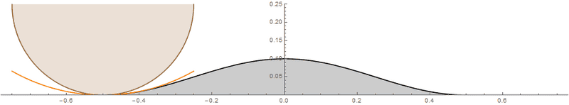

I think we can achieve a reasonable design of the bump without worrying about the case ##r >> h##. Maybe I'm missing something. We do require ##r## to be less than the minimum radius of curvature of the bump.
Here's a particular example. I hope I didn't botch the calculations.
Suppose we take a cosine bump with ##h## = 0.1 m and ##L## = 1.0 m. Then, the bump's minimum radius of curvature turns out to be ##\rho_{\rm min} \approx## 0.51 m.
Let the car move over the bump with speed ##v##= 1.5 m/s. [about 3.4 mph]
Take the tire radius to be ##r =## 0.25 m. I think this is reasonable. Note ##r < \rho_{\rm min}##.
For these numbers, the maximum acceleration of the center of the wheel as it goes over the bump is about 8.8 m/s2, or about 0.9g.
Here is a scale drawing for this case when the wheel is just starting up the bump.
The orange curve shows the curvature of the bump at x = -##L/2##.

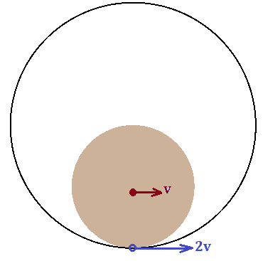

@TSny Very good. Thank you. Just one little puzzle that I'm trying to iron out: What if the curvature of the road continues at a constant radius of curvature to send the wheel into motion around a ring of radius ## \rho ## ? The axle will then be traveling in a circle of radius ## R=\rho-r ##. It never does that for this case though, but hypothetically, we could keep this same curvature at least for a finite distance. Even with a ## \rho ## that is twice the radius of the wheel, to maintain the velocity/speed ## v ## of the axle, the tread on the wheel needs to be moving over the road at twice this ## v ##. There must be a flaw in my logic, but I'm not sure where.
Maybe there is a clue in the actual path the axle covers when it goes over this sinusoidal hill. The position vs. time function is well behaved for the axle.
It seems though our model, and keeping the axle moving at speed ## v ##, seems to encounter difficulty if ## r ## is a significant fraction of ## \rho ##.
Charles Link said:
Just one little puzzle that I'm trying to iron out: What if the curvature of the road continues at a constant radius of curvature to send the wheel into motion around a ring of radius ## \rho ## ? The axle will then be traveling in a circle of radius ## R=\rho-r ##. . . . . Even with a ## \rho ## that is twice the radius of the wheel, to maintain the velocity/speed ## v ## of the axle, the tread on the wheel needs to be moving over the road at twice this ## v ##. There must be a flaw in my logic, but I'm not sure where.
Yes, the geometrical point of contact between the wheel and the ring moves twice as fast as the center of the wheel. I don't see any difficulty with this.
Of course, the physical point on the rim of the wheel that makes contact with the ring is instantaneously at rest for rolling without slipping.
