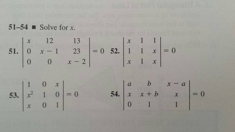

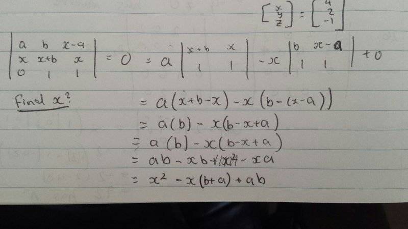

Q54.
Cofactor expansion (along 1st column)

Mark44 said:
What happened to your equation. You're starting with the determinant equalling 0. You lost one side of your equation.
solving the determinant equal to 0
If you're solving an equation, you have to actually have an equation.
In your first line, you start off with "= ..." followed by a bunch of expressions. You seem to have lost one side of your equation.
I think my working is logical. I start off with 0=... and just don't continue writing 0 on the LHS as I solve for the RHS. Ultimately I get 0=x2 - x(b+a) +ab
Okay, can you solve that equation for ##x##?
