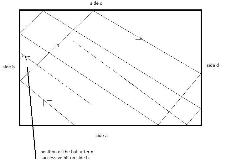

From the picture i.e attached. Can there be a formula, where the ball will strike after certain number of hit, say on side b, what will be the angle the ball will make after n successive hit.
I think it is just not possible, one can only measure the next angle the ball will make, provided one know the present position where the ball has hit.
Thank you.

You would need to know the velocity and position of the ball at some time, the rule followed by the bounce, and the dimensions of the box.

Sorry, my question was not clear, then. Its a rectangle board, where a ball or a striker keep on hitting the side of the wall, assuming no change in velocity. We could take an arbitrary position and velocity to start with.
If the velocity does not change, then there is no bounce.
Recall, velocity is a vector: it is speed and direction. Do you mean that the speed is unchanged after rebound?
Then my comment still holds.
The direction determines the angle of the strike. You can see this from your diagram.
The angle of the rebound depends on the rules for the rebound - maybe the rebound angle is always equal to the strike (incident) angle, maybe not.
Whatever, you need to know the rule.
Technically, since a ball is round, it may also have some spin - which also needs to be known.

I may be wrong again explaining. Just consider, its a computer game, where a line hits the wall of a rectangle(of any length and breadth). Speed of the line is not needed as we are only interested in knowing, at what angle the line will hit the side of the rectangle, after successive rebound. Or at what angle the line will hit a certain side, say side b, after n successive hit to side b.
We can start with say, the line originate from side a, at a certain position, say x distance from right corner and at an certain angle with side a, towards side b(just like in the picture).

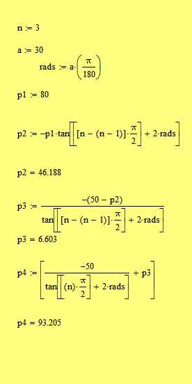

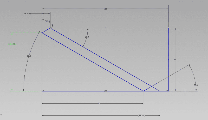

I thought you explained it fine. I may do some more on this but I attached some work to figure relevant coordinates based on initial position (p1) and initial angle (a) to n=3 terms for a rectangle 100Wx50H. This is my first whack at this and these are all unique terms so I don't think this is a practical solution.
Thank you.
There are formulas for everything you want, given the initial position, direction, and the dimensions of the rectangle.
To make things simpler, instead of having a grid that is WxH in size, set up a matrix where every cell is the size of the rectangle.
Now, instead on bouncing, the ball simply crosses from one cell to another. If it starts by moving to the left, the first time it crosses a vertical line it will correspond to side B and then it will switch back and forth between B and D. Similarly for moving right, up, and down. Every time is crosses a horizontal line, the cell will correspond to a mirror image of the previous cell - switched top-to-bottom. For a vertical line - switch left to right.
Since the B-side vs D-side switches every other time, and crossing a vertical line causes the polarity to switch every other time, crossing vertical lines will not cause the angle at B to change. On the other hand, every time it crosses a horizontal line, the angle will switch.
So let's say that the ball starts along the bottom of the HxW rectangle from a point that is X from the bottom left corner where 0<=X<=1 and 0 is the left corner and Y is the right corner. Then, it strikes the left side at a point that is Y from the bottom left corner where 0<=Y<=1. So, on the first bounce, it will strike side B at an angle of S=atan(HY/WX). On subsequent bounces it will strike at either +S or -S.
On the Nth bounce, it will have traveled horizontally W(2(N-1)+X) and vertically H(Y/X)(2(N-1)+X). The number of horizontal lines it would have crossed would be that vertical distance divided by the height and truncated to an integer: Int((Y/X)(2(N-1)+X)).
Since the angle will flip that number of times, we will take modulo 2 and generate the sign of the angle from that:
atan(HY/WX) (1-2(Mod2(Int((Y/X)(2(N-1)+X)))))
