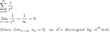

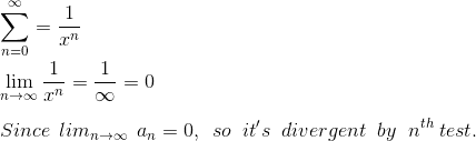

Infinite series sum from n = 0 to infinity of 1 divided by x to the n-th power, written in plain mathematical notation.
Here's my work :
Typeset math: the sum from n=0 to infinity of 1/x^n, then the limit as n approaches infinity of 1/x^n equals 1/infinity equals 0, then 'Since lim a_n = 0, so it's divergent by n-th test.'
However , the correct answer is :
Typeset equation: sum from n = 0 to infinity of 1 over x^n equals x over (x minus 1), when |x| > 1.
Handwritten-style line of text reading: By the geometric series test, the series converges.
Can anyone tell me where's my mistake ?

Is this the full problem statement? You need to specify a value for ##x## to know whether the series converges or not. Furthermore, there really should be no ##=## inside your sum.
Yes.
Fatima Hasan said:
Yes.
I am sorry, but it cannot be the full problem statement. A full problem statement is not just a sum without specifications of what goes inside it. Please reproduce the full problem statement exactly as given.
