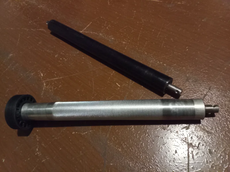

I want to make a roller bike trainer. Right now, I only have two rollers from a treadmill for the rear wheel of the bike. My question is: why is it so hard to turn the pedals compared to the rollers on a factory-made bike trainer? The shafts have 6202 RS and 6203 RS bearings, with cylinders having wall thicknesses of 2.5 mm and 3 mm

The roller diameters are 40 mm and 46 mm. The distance between them is 19 cm. The outer diameter of the rear wheel is 28 inches. The tire pressure is 45 PSI
How heavy are the rollers? Are they easy to turn by hand? Can you upload a picture? (use the "Attach files" link below the Edit window)

The roller weights are 1.75 kg and 2.2 kg. They are not difficult to spin, but even with my maximum effort they make at most three revolutions. The frame is currently disassembled

The 620xRS bearings have rubber lip seals that will drag if dry, and may stop the rollers spinning freely. If after cleaning and oiling, you want them to spin for longer, then you will need to use the 620xZZ suffix bearings that have a metal screen on both sides, without frictional contact.
You should make sure that the bearings are free, and have not worn, wound up hair, or have dried grease on the shaft. Clean the bearings and lip seals, then lubricate with light machine oil. You can usually pop the rubber seals carefully off the side of the bearing, which will allow them to be cleaned and then reassembled.

Sorry, what does this mean? Are you saying that when you spin them by hand and stop pushing on them they only rotate 3 times before stopping?
Yes, that’s correct. After being spun by hand and released, they only make about three revolutions before stopping
Sounds like the bearings need to be replaced. Unless you like the resistance training on your bike when using the rollers... :wink:

A bicycle is designed to roll freely across a flat surface, on a wheel with a radius of about 15". You have rollers with a radius of less than 1", so I think the rollers are too small in diameter, or the tyres are much too soft for those rollers.
I asked Google what size rollers are typically used, and it replied: "Bicycle trainer rollers typically range in diameter from 57mm to 114mm (roughly 2.25 to 4.5 inches). The specific diameter determines the resistance level and difficulty, with smaller rollers generally providing higher resistance, while larger rollers offer lower resistance".

That seems small, to me. If you measure the distortion of the tyre in contact with the rollers it could be quite high - producing higher rolling resistance higher than on a flat surface. If you measure the amount that the frame lowers as you add you body weight then that would be the height that you are raising your weight, each rev of the roller - which would represent work done. Are the rollers comparable with the factory made trainer?
The rollers on the factory trainer are about twice as big. I wanted to use these rollers for testing, but I still didn't think it would be so hard to turn them
