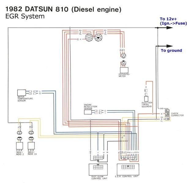

The Nissan LD28 diesel changes injection timing depending on egr operation.
It's part of the engine management scheme.
It's possible this ford engine does the same.
Best thing I can recommend is to learn how they go about managing egr on that engine from the manuals.

Here's a couple of pics from the net but I can photocopy the 10 pages in the factory service manual that describes all the operating parameters.
I'll do it later today.
The throttle plate is there to create a larger pressure differential between the intake and the exhaust when in use.
Thats some excellent stuff, thank you so much for taking the time to upload those. It seems clear to me after closer inspection to the engine that its likely the mechanical pump is variable which explians my results dilemmal, thanks again to everyone who gave me some direction on this one.
