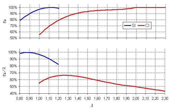

The confusion comes from the definitions of "rich" and "lean" in both cases.
A gasoline engine is meant to be used a given fuel ratio. On an efficiency point of view, it should be at the fuel ratio burning all the fuel. If you deviate from that "ideal" fuel ratio, some fuel is not burn, thus wasted. If you decrease the fuel amount, the heat will drop accordingly. The thing is that if you increase the fuel amount, the percentage of fuel burn decreases, but there is more fuel and it more than compensate for the expected power loss due to mixing inefficiencies; In fact you get a power gain. This is only true to a certain point though. So you get an effective fuel ratio range going from "most efficient" to "most power" that are label from "lean" to "rich". The limits are around ##\lambda## = 1.12 (lean) and ##\lambda## = 0.875 (rich).
With a diesel engine, it's different. We actually control the power output with the amount of fuel injected in the mix. To get little power, you inject as little fuel as possible and you increase the fuel amount to get more power. The problem with diesel engine is that the richer it gets, the harder it is to mix the fuel well with the air, thus decreasing efficiency (but not power). There is an upper limit where you cannot compensate the efficiency drop by adding more fuel, just like for a gasoline engine. So you get an effective fuel ratio range going from "low power / high efficiency" to "most power / low efficiency" that are label from "lean" to "rich". The limit is around ##\lambda## = 1.25 (rich) and there is no limit for lean (as little needed to run the engine).
So the "rich" air-fuel ratio of a diesel engine is actually leaner than the "lean" air-fuel ratio of the gasoline engine.
The following figure shows the actual effects of air-fuel ratio:
The top graph relates air-fuel ratio combustion efficiency to the air-fuel equivalence ratio for a spark-ignition (SI) and compression-ignition (CI) engines.
The other graph represents the actual amount of fuel burn vs the air-fuel equivalence ratio for the same engines.
For a diesel, anything above ##\lambda## = 2 burns efficiently, but produces less and less power as you increase the value. The maximum power happens at 1.25 - only use in a racing context due to the enormous amount of soot produced (see below); production vehicles usually don't go under 1.65.
This is the info I was looking for, thank you very much! Interesting graph's as well.

The point was to show that diesel and gasoline engines are not operating in the same air-fuel ratio range. Technically, a diesel engine air-fuel ratio is never "rich", i.e. below stoichiometric ratio. So you cannot compare a "rich" gasoline air-fuel ratio with a "rich" diesel air-fuel ratio.
Work Hard Play Hard said:
First, ICE efficiencies are fleeting. What would happen to your chart if you took 5 different engines and graphed the effects of each engines AFR's at 5 different RPM's? Additionally what would happen at various loads applied to the engines? Loading aside I think there would be 25 different graphs.
The efficiency I considered was only the portion related to the air-fuel ratio (##\eta_{\lambda}##). The graphs I've shown represent equations found in Design and Simulation of Two-Stroke Engines:
[tex]q_{in} = \eta_o \eta_{SE} \eta_{\lambda} \frac{q_f}{\lambda AFR_s}[/tex]
Where:
  • ##q_{in}## is the heat available for combustion;
  • ##q_f## is the heat available from the fuel;
  • ##\lambda## is the air-fuel equivalence ratio;
  • ##AFR_s## is the stoichiometric air-fuel ratio;
  • ##\eta_o## is an overall efficiency that express the incomplete combustion due to incomplete flame travel into the corners of particular combustion chambers, weak or ineffective ignition systems, poor burning in crevices and flame decay by quenching in most circumstances;
  • ##\eta_{SE}## is defined as the mass of fresh air with respect to the total mass trapped inside the combustion chamber prior to the combustion; since exhaust gas may not have completely escape the cylinder during the previous cycle;
  • ##\eta_{\lambda}## is the combustion efficiency due to the air-fuel equivalence ratio and is defined as:
For a SI engine with ##0.80 < \lambda < 1.20##:
[tex]\eta_{\lambda} = −1.6082 + 4.6509 \lambda − 2.0746 \lambda^2[/tex]
For a CI engine with ##1.00 < \lambda < 2.00##:
[tex]\eta_{\lambda} = −4.18 + 8.87 \lambda − 5.14 \lambda^2 + \lambda^3[/tex]
For a CI engine with ##2.00 \le \lambda##:
[tex]\eta_{\lambda} = 1.00[/tex]
Out of range values for ##\lambda## will make ignition difficult.
The top graph represents those equations, the second graph represents the same equations divided by ##\lambda## (from ##q_{in} = \eta_o \eta_{SE} \frac{\eta_{\lambda}}{\lambda} \frac{q_f}{ AFR_s}##).
