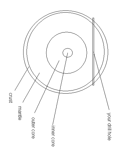

Ok, I am sure similar questions have been asked but here it goes.
You start digging a hole with the intention of digging straight through the planet. Your hole will be straight but will only go through the mantle, missing the core and outer core, so you have avoided the weightlessness of the Earth's core. So what happens? you keep digging down and you get closer the surface on the other side of the world. Do you at some point fall back? when do you become upside down?
depending on where you dig from and to, you may be digging sideways
consider this ...
you cannot drill at 90 deg to the surface and miss the inner or outer core
consider this ...
View attachment 106703you cannot drill at 90 deg to the surface and miss the inner or outer core
So let's say you start about 2 thirds to the left or right of the YOUR DRILL HOLE point. That would mean your hole is vertical and misses the core.

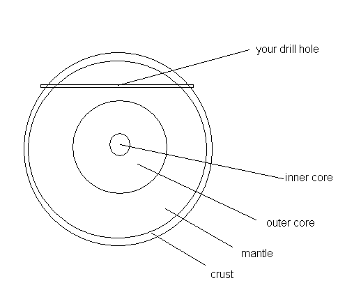

Do you mean like this?
You do realize that "vertical" means towards the centre of the Earth, not towards the bottom of the piece of paper you draw the diagram on?

The point is to dig a hole that you could fall through without touching the sides, that is not at an angle and misses the core.
I could ask what would happened if you could dig a hole straight through the Earth's core but I think that question has been answered.
but it is and has to be at an angle to the Earth's surface ( as I said earlier)
you cannot dig/drill a hole that is vertical (perpendicular) to the surface and not miss the core
look again at my drawings my original and the one Dr Greg rotated ... BOTH ends of the hole are at an angle to the surface
we just need you to get that sorted and understood, before tacking the gravity issueDave
Glad to see I'm not the only one who manages to say the opposite of what he means. :smile:
There is no such hole. If you can fall through it without touching the sides then the hole is vertical. If it is vertical then it points towards the core.

I think this is all going off topic a bit and too much is being discussed about my "vertical" hole, what I am interested in is what would happen to the person digging, he can be digging on anybody that has enough gravity to keep him grounded. So for example, he could be digging through the Rosetta comet, ad on the other side a person is also digging a hole. Eventually there holes will meet. From person A's POV person B is digging up and he is digging down. If they both jumped into the hole they'd land on each other's feet. Now if they are both lowered into the hole using a lift/elevator there feet will be on the floor of it, but as they get closer eventually they become upside down, so do they fall toe the ceilings of their lifts?
The person digging the hole shown in post 9 is not digging a hole per se, but rather they are digging a tunnel. That tunnel slopes downward at one end, is level in the middle, and slopes upwards at the other end. The digger could stand on one side the whole way, assuming they had enough traction at the ends.
No. At all times gravity pulls them towards the centre of the planet not the centre of their tunnel. So when they meet at the mid point they only experience a sideways force acting towards the middle of the planet. Neither would feel "upsidedown" they would feel like they were laying down on the sides of the tunnel.
