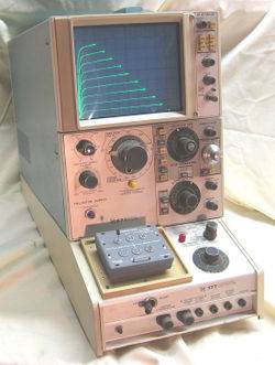

I use a traditional CRO because I like to explain about the electron beam as part of the lesson, and show the effect of a magnet. It is many years since I tried a digital scope in a classroom and I found a slight processing delay which meant that the image did not relate to the sound being displayed.
Oh, I'd love to have an old CRO one - but unfortunately I need to make the most of what I have.

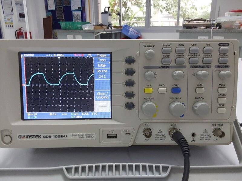

Look!
Nice!
A couple comments: You are displaying Ch2 (blue) which is where you are connecting your input signal, but you are triggering on Ch1 (yellow). That is shown in the status menu on the right of the display. Also, the trigger point (for Ch1) is set slightly above the waveform (see the little yellow triangle on the right edge of the graticule). You should switch your trigger source to Ch2 and adjust the level to put the little blue trigger level triangle in about the middle of the waveform.
Keep it up! :smile:

berkeman said:
Nice!
Keep it up! :smile:
I know! I tried to set the trigger and lost it completely so switched to Channel 2.
But.....I had taken the little blue triangle to be the centre line, that's how I centre my trace.
I might not get time today but will have another look at the trigger thing.
One other tip -- To use the trigger level setting function, you need the channel's coupling to be "DC", not "AC". At least in my experience that is true. So if you were having trouble getting the trigger to work reliably on Ch1, check the coupling for that channel. In fact, on my 'scopes, they won't even show the little trigger level triangle when the channel coupling is set to "AC".

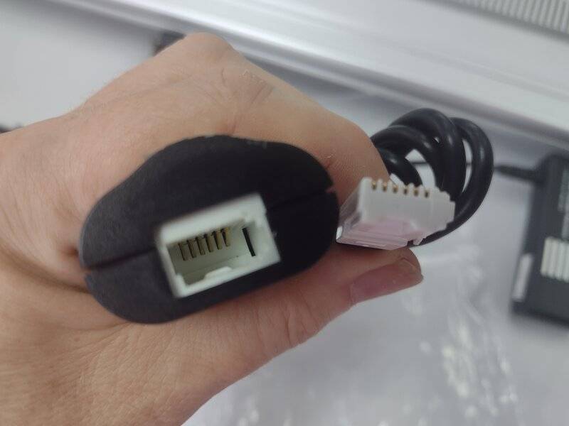

Good news, today while looking through a box of (apparently unused) Vernier sensors we have, I found two oscilloscope cables! They are the type with the probe but will do the job nicely.
But, while looking through those Vernier sensors (photogates, light sensors, pd, pH etc) we have found that we can't connect them to the interfaces (GoLink and LabQuest) they came with. They look as though the connectors are on backwards.
It's been a long week and it might be that I'm missing something here, but have a look at these - they don't fit, do they?
