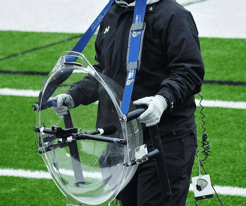

Well, there is the typical parabolic sound amplifier, but it's not very stealthy, and doesn't work if the folks you're snooping on are on the other side of a window...
https://i.pinimg.com/originals/49/e9/21/49e92104dcb7ee073b6e2fabe121018b.jpg

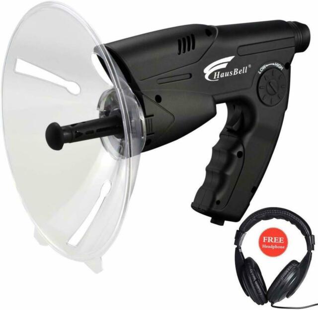

What brand and model is the most sensitive in the world? I plan to buy one just to test how good it is.
https://www.ebay.com/c/600083263
this is an example of many out there but I'm not sure of the quality:
Not that little biddy one, that's for sure.
Quiz question -- why?
I think it's like a telescope. The bigger aperture, the better. I once had an 8 inches SCT telescope and a 4 inches. I wish I had a 12 inches SCT.
What is the biggest aperture sound amplifier available commercially and available to public? But if the amplifier is high quality and can eliminate noises. I guess it counts a lot too.
The lowest frequency for telephone quality speech is 300Hz, which has a wavelength of about 1m. So how is a parabolic reflector about 200mm diameter going to do anything?? Why does it have holes in it, is there a profound reason?

I'll have only a one time shot to buy a 1 meter sound amplifier, for research or study purposes. If I buy a bad quality. I can't buy a second one (no budget). So has anyone seen or known the best brand of 1 meter sound amplifier out there? What brand is the one (pictured) shown in message number #2?
In the case of an ear trumpet, part of the effect is the matching improvement between the impedances of the air and the ear drum. But I am not sure if a parabolic reflector will help the matching problem.

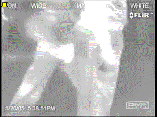

Just like I acquired a thermal imager for fun.
Ah, so it was you. . . . 😒
My only useful application for it was detecting ceiling with wetness above it from leak in roof that can't be seen from below.
It's rectangular plywood ceiling attached on long wooden bars. You can see the wooden bar as long shadowed. The very violet is more water than the lighter violet. You can't see the water yet from below because it hasn't leak yet. Too bad the resolution is only 140x140 pixels. I should have acquaired 640x640 for use outdoor in the forest to detect animals (but I don't camp anyway).
