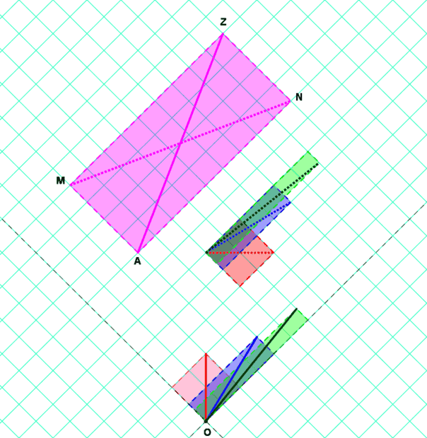

Kairos said:
## \Delta s =1 ## (not directly visible on Minkowski diagram)
With a little guidance, imagination, and some practice counting,
one can visualize the squared-interval ##\Delta s^2## on a Minkowski spacetime diagram.
Rather than visualize hyperbolas, one can visualize causal diamonds (parallelograms with lightlike sides, formed from the intersections of lightcones). Thus, these are Lorentz invariant.
  • Below is a triplet of timelike segments from event O with ##\Delta s^2=\Delta (ct)^2 - \Delta x^2=4##.
    The diamonds have area 4 and these are segments are their timelike diagonals. So, ##\Delta s^2=+4##. (The corners opposite to event O do lie on a hyperbola of "radius" 2 "centered" at O.)
    (Instead of a ruler you can rotate,
    imagine a deformable constant-area parallelogram with sides parallel to the gridlines.)
  • There is also a triplet of spacelike (dotted) segments with ##\Delta s^2= -4##.
    These diamonds have area 4 and these are segments are their spacelike diagonals.
  • ##\Delta s_{AZ}^2=+36##, ##\Delta s_{MN}^2=-36##, ##\Delta s_{AM}^2=0##, ##\Delta s_{AN}^2=0##, ##\Delta s_{MZ}^2=0##, ##\Delta s_{NZ}^2=0##
  • ##\Delta s_{OZ}^2=132## (count the grid diamonds)
    ##\Delta s_{OZ}^2=11.5^2-0.5^2## (count along the grid diamond diagonals)
details: https://www.physicsforums.com/insights/relativity-rotated-graph-paper/
