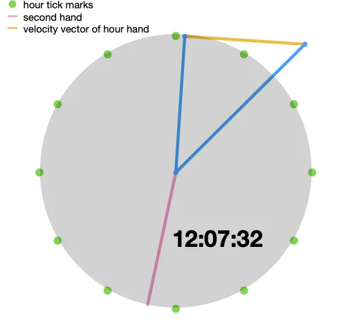

Consider which way the velocity of the hour hand's tip points at that moment.

Treat the minute hand as fixed (i.e. work in the frame of the minute hand).
The tip of the hour hand moves at constant speed. It will be moving away from that of the minute hand fastest when its motion is directly away from it, so the line joining the tips is tangential to the locus of the tip of the hour hand and make a right angle to the hour hand.

It looks as though that statement came out of my head before I finished my doodle of the problem.
I should get some kind of award for having never even considered going into teaching as I am such a bad communicator in maths, that I will look back at my old posts and claim; "This guy is an idiot."
Except for the reversal of the hands, that looks very much like what I meant to say.
With the exception of the "It will be moving away from that of the minute hand fastest when its motion is directly away from it" statement. It sounds like 'a priori' knowledge to me. Perhaps having never been a science and or math instructor, I never ran across this particular problem.
In any event, after thinking about it for a few seconds, I now get it. Thanks!
