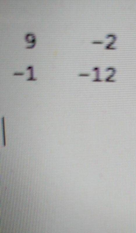

Okay for 3-D if the grid points are (111),(121),(211),(221),(112),(122),(212),(222) and the values of ##v_x,v_y,v_z## are known at these points ,then can anyone please help me in how to write program in MATLAB to compute divergence of ##\vec v## without using ##meshgrid##
In 2-D if the grid coordinates are (1,1),(1,2),(2,1),(2,2) and ##v_x,v_y## at these points are (3,4),(8,9),(7,10),(1,5) then how to write correctly in MATLAB to calculate it's divergence??(without using ##meshgrid##)
Mine is showing something like
MATLAB Command Window screenshot: x=[1 1;2 2], y=[1 2;1 2], u=[3 8;7 1], v=[4 9;10 5], then divergence(x,y,u,v) returns ans = Inf NaN; NaN -Inf.
The correct ans. will be
Four numbers in a 2 by 2 arrangement with no surrounding labels: 9 and -2 on the top row, -1 and -12 on the bottom row.
Can anyone please help...
