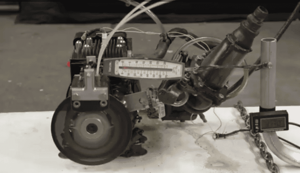

Hi, I have to measure the HP of a small engine at the crankshaft. The only usable things are.
A dinamometer
A brake disk
An rpm meter
The brake caliper is floating so when we apply de load it pull the dinamometer.
The rpm meter show the revolution during the load apply. It can works?
How I should do the measure to find the HP every 1000 rpm?
Here the picture of the project.
Please if is possible show me the procedure step by step.
Thanks!

$$HP = \frac{2\mu rN \times RPM}{5252}$$
where:
  • ##2##: because I assume there are 2 brake pads
  • ##\mu##: the friction coefficient of the brake pads
  • ##r##: the disc radius, ft (to the middle of the brake pads)
  • ##N##: the normal force applied to the brake pads, lb (which I assume is directly measured by your "dynmometer" (fishing scale?))
The problem with this set-up will probably be the friction coefficient that will change as the disc heats up. You will need a really efficient cooling system to maintain the disc temperature.

1) Set the engine throttle wide open.
2) Adjust the brake to get 1000 RPM. Read force on the scale.
3) Adjust the brake to get 2000 RPM. Read the scale.
4) Continue until done.
5) You now have a series of RPM and force measurements. You know the moment arm from a measurement. Force times moment arm is torque, and power is torque times RPM (watch your units).

I believe the dynamometer is configured to stop the rotation of the "floating" brake caliper and so directly reads the tangential frictional force (not the normal force as you indicate). This will make the measurement a little cleaner and independent of the brake efficiency. It may require a calibration factor because of the moment of the forces/torques.
Correct the dinamometer is fixed to the floating caliper and on a stationary arm on the other side.

Yes, but I think he has a simpler set up. Since he can measure all of the tangential force applied, 2μN can be replaced by whatever his force measurement is. The only problem with the coefficient of friction changing with temperature (or anything else) is that it will change the operating point (RPM & Torque). presumably this will happen slowly enough that it can be adjusted in real time.
