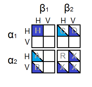

Paul Colby said:
Now, I’m going to choose two sequences of events of identical in length, say ##N##, from our much bigger deck. The first is simply the first ##N## cards of the big deck. The second I am going to choose card ##k## such that ##(\alpha_k,a_k)## is the same as Alice’s results for the ##k##-th card in the first deck. What this does is it gives us two experiments in which Alice’s event sequence is identical in both decks. Both of these experiments could happen even though arranging it real time is not possible (well, very very unlikely at best). Both experiment time sequences are completely consistent with QM. At this point I ask; can we really claim that Bob’s measurements have effected Alice’s? How is such a claim made since both Alice’s results are identical between the two time sequences while Bob's are completely different?
There are carefully chosen angles ##\alpha_k## and ##\beta_k## for which you can't carry out that procedure for several steps (same subset for Alice -> different subsets for Bob -> same subset for Alice for both Bob's subsets but different as a first Alice's subset) even if you allow arbitrary cherry picking. That is basis for Eberhard's version of Bell inequalities.
If I was looking for or claiming a loophole you'd have a good point. I'm not looking for or believe I require one to make the point I'm attempting to make[1]. The cards are produced by measurements and must obey QM at every level. They are simply records of Alice and Bobs angle settings and measurement results. The probability of each event is ##P(\alpha_k-\beta_k,a_k,b_k)## just as QM predicts. The cards are originally taken in a the order in which the measurements were made. The events are independent of each other. The order in which the events occur does not enter into a calculation of the correlation, only the frequency of the events is used. The first set of cards is taken as the first ##N##. The second is in very large measure just a permutation of remaining cards. The reason exactly ##2N## cards is insufficient is due to the statistical fluctuations in the numbers cards produced.
