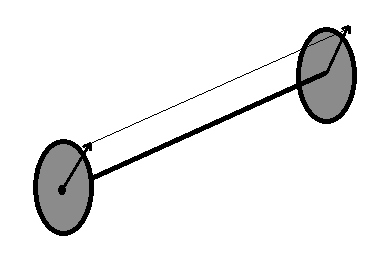

The figure is my drawing of a pair of clocks joined by a stout metal rod through their centers. The hands of the clock rotate in sync because the clocks are synchronized. A delicate glass rod connects the tips of the clock hands. If one of the clock hands advanced more than the other, the glass rod would twist, stretch, and break. But as long as the clock hands move in sync the glass rod will not be stressed and it won't break.
When this device is placed in motion in a direction parallel to the connecting rod, relative to the observer who synchronized the clocks when they were at rest, the clocks will no longer be synchronized (relativity of simultaneity). This will cause the glass rod to break. But if another observer moves with the clocks, they would remain synchronized in his frame of reference and the glass rod wouldn't break. So, does the glass rod break or not?

As I said, it was written poorly. Let me try again.
Shown in the figure is a pair of clocks joined by a stout metal rod through their centers. The clocks are synchronized in their rest frame so that the hands rotate in sync. A delicate glass rod connects the tips of the clock hands. If one of the clock hands advances more than the other, the glass rod would twist, stretch, and break. But as long as the clock hands move in sync the glass rod will not be stressed and it won't break.
An observer in motion along the line joining the clocks will conclude that the clocks are not synchronized and so expects the glass rod to be broken and disconnected. But an observer at rest with respect to the clocks will see them in sync and so expect the glass rod to be intact and unbroken. The glass rod can't be both broken and unbroken. Can you explain which it is and why?

You are correct. Let me try again.
An observer at rest with respect to the clocks will see them in sync and so expect the glass rod to be intact and unbroken. An observer in motion along the line joining the clocks will conclude that the clocks are not synchronized. Should he expect the glass rod to be broken? Can the glass rod be broken according to one observer and not broken according to another? Explain your answers.

Ok, the answer to this version is just what I said before: since you specified that the glass rod is not broken, then it's not broken. The rod cannot be broken according to one observer and not broken according to another. To put it another way, the stress in the glass rod (which is what would cause breakage if it were present) is a tensor, so if it is zero in one frame (and you specified that it was zero in the frame in which the clocks are synchronized), then it is zero in every frame.
By the way, even in the rest frame of the clock there will be some stress in the glass rod since it is being centripetally accelerated from the ends.
