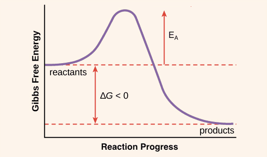

I've been researching a lot of chemistry lately and one thing confused me, apparently some spontaneous reactions require activating energy?
At least thats what i found on Google but would it be contradicting the spontaneous part? Like when i think of spontaneous reaction i think like Nitroglycerin, a compound that explodes violently if not taken care properly. So spontaneous should not need any activating energy since its own energy would have enough to start the reaction right??
But then i found out burning wood is also a spontaneous reaction and basically any combustion reaction and also diamonds turning into graphite is also a spontaneous reaction since it get less energy after turning into graphite. All of them need some kind of energy to kickstart the reaction and all of them are spontaneous reactions.
Sooo can anybody explain to me whats going on? Thank you👍

There are two kinds of stability - thermodynamic stability and kinetic stability. Something can be ready to react and follow thermodynamics, but unable to do so for kinetic reasons (reaction is way too slow). That's where the activation energy comes into play.
In a way every reaction that follows thermodynamics is "spontaneous" assuming temperature is high enough. Cool it down and kinetics comes into play.

Where EA is the activation energy. If you spend some time in synthetic chemistry, you will find that some reactions just stands still and still and still until the hotplate reaches the right temperature and reaction is instant (not always this ideal).
I have always interpreted this as practical demonstration of the above.

No, activation energy is needed always, see the plot Mayhem posted. It may just happen that if the temperature is high enough enough molecules already have thermal energy high enough to overcome the energy barrier (average energy per molecule is proportional to kT - the higher the temperature, the higher the energy).
