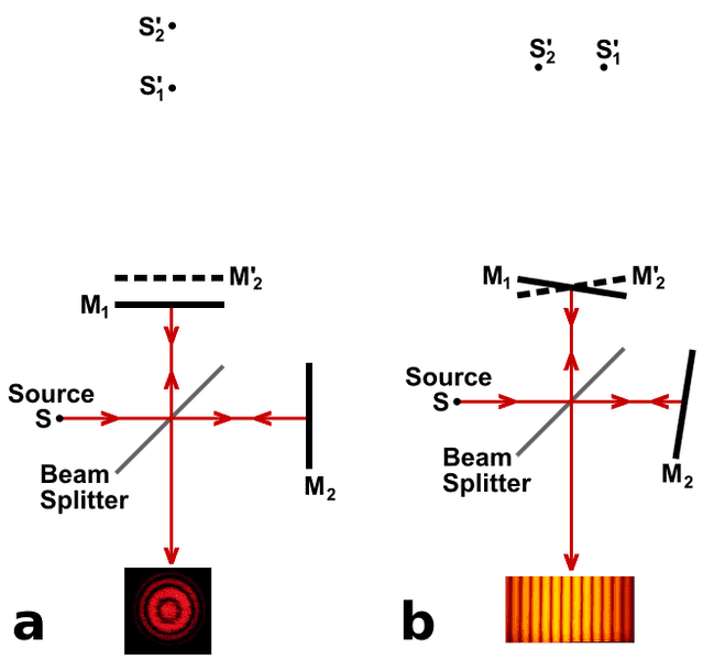

I got the opinion that the beam splitter could be used alone not from these sources describing entanglement experiments, but rather from something called the Michelson interferometer. Unlike you, I do not understand the difference between interference and entanglement. What could it be? Can you help me understand what other elements are needed in this interferometer to entangle the input photons?
https://en.wikipedia.org/wiki/Michelson_interferometer
It uses mirrors, a beam splitter and a detector to create interference patterns.
Entanglement happens when the particles physically interact (exchange information) with each other which correlates their quantum states to a single state; quantum interference is about the superposition of the wave functions which give the probabilities of events.
Entanglement is pretty much demystified if you think that after their interaction both entangled particles carry information about both particle's state but this information is in superposition prior to measurement as is everything in quantum mechanics.

I'm sorry but that page mentions BBO crystals which create entangled particles rather than entangling independent particles. We were asking each other about setups that entangle previously independent photons.

The reference kvantti provided you does entangle photons. I don't know if I would use the word "independent" to describe them though. I think you are asking whether 2 unentangled photons can be entangled with some kind of classical apparatus like an interferometer or a beam splitter. Generally, the answer is no because the photons are distinguishable. To be indistinguishable, they must usually be phase matched. To do that, you need all kinds of other gear. QED.

You have answered your own question when you mention 2 photons interacting. How are they going to do that? They would need to arrive close together, so close that the arrival time would not distinguish them. Or alternately that their arrival times are "smeared out" and therefore overlap partially (and will only be partially entangled - as Nugatory is alluding to: "some degree of entanglement"). Etc.
So what needs to be done to accomplish that? Clearly, that is the rub. To have a degree of entanglement that can be subsequently measured to exist: that won't really happen in practice without the complex setups. Such as the reference you provided, which is anything but simple. :smile:
