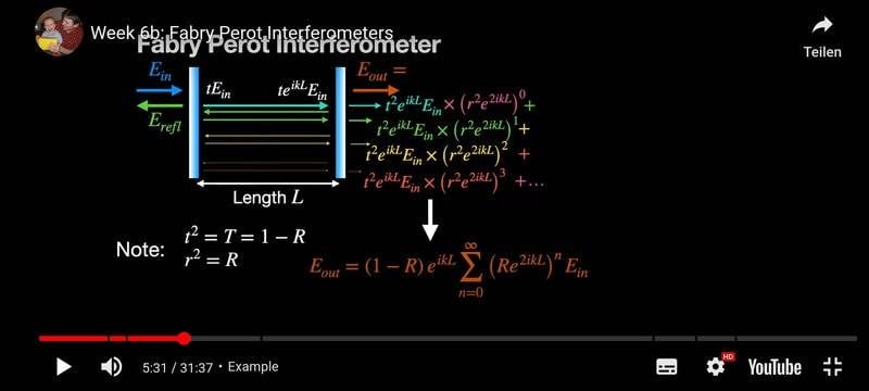

I'm trying to understand the Fabry Perot interferometer and came across this amazing video.
Video frame of a Fabry Perot interferometer diagram with two mirrors separated by length L, showing repeated reflections and the series Eout = (1 - R) e^(ikL) sum of (Re^(2ikL))^n Ein.
Basically it all comes down to adding E-fields together with each of them being delayed by the cavity round trip time. In the extreme case, either they all interfere constructively at the second mirror and the transmission goes to 100% if the length is an even multiple of half-wavelength and close to 0% if it's an odd multiple according to the airy formula.

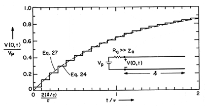

Now I'm wondering how the FP could react to a step response of coherent CW laser light. In my EM class we did a step response for transmission lines. The result is similar to the charging of a capacitor but it's discrete because the wave takes some time to come back and interfere (round trip time)
Staircase-like plot of V(0,t)/Vp against t/τ from 0 to 2, rising toward about 0.9, with a smooth curve overlaid; labels mark Eq. 24 and Eq. 27 and the step width 2(ℓ/c)/τ; inset shows a voltage source Vp, resistor Rg ≫ Z0 and a line of length ℓ.
Would it look the same for a FP? And if yes, is this something that can be measured with an oscilloscope? For a 1m cavity, the steps should be 1/c seconds long, so approx. 3.3 ns, this shouldn't be a problem but I haven't seen anyone measure it...

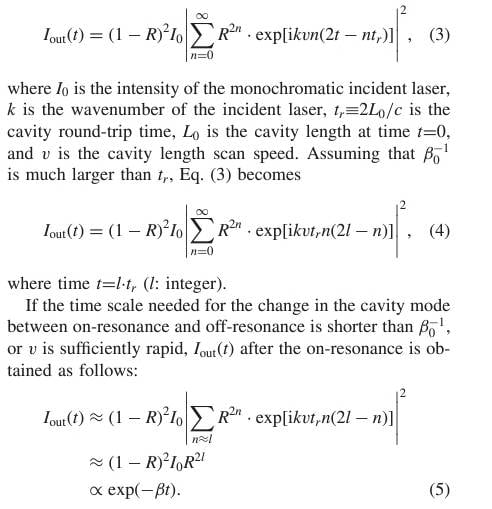

I came across this paper called "Rapid-Swept CW Cavity Ring-down Laser Spectroscopy for Carbon Isotope Analysis"
Equations (3) to (5) for transmitted intensity of a Fabry-Perot cavity: a sum over n of R to the 2n times exp(ikvn(2t - nt_r)), squared, then approximations giving an exponential decay exp(-βt).
Here they seem to ignore all the discrete summation and just approximate the solution as a decaying exponential. I've seen the exponential various times without addressing the individual charging steps. Is there a flaw in my model? Thanks!

The "round trip Time" determines the input input impedance of the input port. As the frequency sweeps, there will be frequencies at which there is total reflection of the incident power so the energy levels between the two ends of the line will vary between cancellation frequencies. I see no reason for the FP to behave differently from a regular RF transmission line (as long as the model is correct and the effect of geometry on spreading the path length differences can be ignored).
IMO, the 'staircase' graph is insufficient to describe what's really going to be observed because the equivalent to the drive voltage will not be constant for the FP. A better model would have to be a length of transmission line with two transitions, spaced out and where the impedance steps produce appropriate reflections along the path.

Also, I don't quite understand why it can't be a CW laser sweep. Couldn't you just place a Q-switch before the laser to toggle it? The FP cavity would have to be long enough, so that the step separation is longer than the rise time of that Q switch, but that shouldn't be an issue, as the FP cavities in LIGO are 4 km long. I can't imagine how that cavity doesn't charge in steps.
If you work out the geometric series, you get exactly this exponential charging curve. The equivalent to voltage is the amplitude of the electric field wave.
