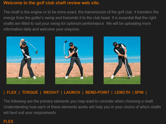

Actually, this brings up a larger question about impacts, but I don't know if we want to go there in this thread. Maybe a different thread? How do you optimize energy transfer in manual impacts for different scenarios...?
http://www.golfclubshaftreview.com/

I believe it. .My knowledge is about golf clubs and swings. For the golf swing it is key for your joints to be loose and relaxed. The club head lags behind your hands and arms then naturally catches up, ideally reaching a peak at the time it encounters the ball. Golf club shafts are flexible for the same reason. Weaker golfers use more flexible "whippy" shafts. Using a sledgehammer or hitting a baseball works the same way. The mistake most beginners make is tensing up and trying to muscle the ball. A relaxed smooth swing is much better. Once you've got that you can speed it up gradually.
Hitting the ball or whatever precisely in the center of percussion of the club or bat or whatever is important too. This avoids energy-absorbing lateral vibrations in the club or bat. Golfers call it "hitting it pure." Ray Guy once punted a football so "pure" it hit the dome of the Astrodome. He said he felt less impact on his foot than usual.
