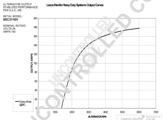

I did a little digging around on the mfg. website. There are several points for the OP to consider:
1. The mfg. lists the alternator model 8SC3110V as being superseded by a newer model.
2. It is not apparent where the torque value of 47 N-m is given.
3. The system voltage is listed as 24V, rather than the 12V on the data sheet.

Well, goodness i sure missed that datasheet link in post #4 !
http://news.prestolite.com/drupaldocs/C-3576-2_8SC3110V_150a.pdf
Datasheet Graph shows torque peak ~ 13.6 ft lbs at maybe 2750 RPM which calculates 7.12 hp,
just about what the dotted hp line on same graph shows .
and at output of 14.5 volts and 150 amps, which is 2175 watts, which is 2.91 hp, that's 41% efficiency.
41% seems a bit low if typical is 50 to 60:.
Datasheet says "heavy duty" so maybe it has an oversize fan. I have an old Leece-Neville truck alternator that has quite a large one compared to the one on a passenger car...
And a fan explains input power continuing to increase with RPM.
So to OP: yes, they take substantial torque.
Please check my arithmetic, and my interpolation on that graph you linked.

Thanks! I just dropped by there also, and read up on that alternator. They posted a graph of current output vs rpm.
http://www.prestolite.com/productinfo/alternators/8SC3110V/8SC3110V_curve.jpg
That explains the shape of the hp curve in the original graph.
This alternator is special use, designed to be run at one speed, and is not to be hooked up to a battery.
The 8SC3110V is a alternator designed for bus air conditioning systems...

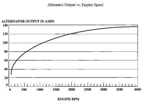

Automotive (diesel) alternator:
[/PLAIN]
Ref
50 amps at 200 rpm? Good god. (note to self: get one of those for your windmill project)
8SC3110V special use alternator:
Zero output at 1400 rpm!
Good god. It's spinning 7 times faster than the automotive beast, and putting out nothing! And the automotive beast is capable of putting out 9 times what I need just at idle.
Gear this one up to 700 rpm, and with a 8000 rpm limit on the alternator, you get a 4000 rpm limit on the engine. Definitely designed for a diesel.
look closely at that graph - on horizontal axis it is engine rpm
and other one is alternator rpm.
