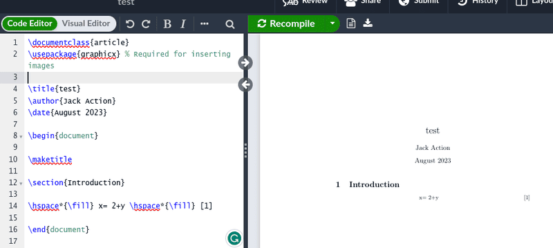

it's a tool using overleaf api, not public. Not working on overleaf is obviously the problem.
First time use with overleaf, but it does work:
But I had to specify \usepackage{amsmath}. It works with align and equation alike.
Without using additional packages, I achieve it with \hspace*{\fill} x= 2+y \hspace*{\fill} [1]:
Edit: Actually you have to use \hspace*{\fill} $x= 2+y$ \hspace*{\fill} [1] to get it written as an equation. (In my example it is pure text.)
