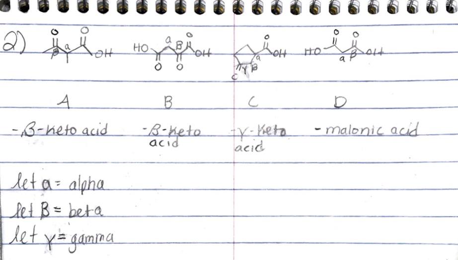

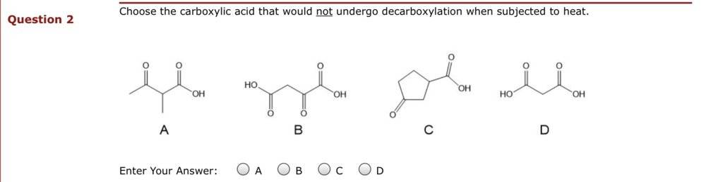

Choose the carboxylic acid that would not would not undergo decarboxylation when subject to heat.
None needed.
Hello all!
I have learned beta-keto acids are able to undergo carboxylation when subjected to heat. Do gamma-keto acids undergo decarboxylation when subjected to heat as well? If not, why?
I identified C as a gamma-keto acid. Do you agree?
Thank you for your help.

Think about the intermediate present in beta keto carboxylates which assists the removal of CO2. Is that possible for your gamma keto compound?
