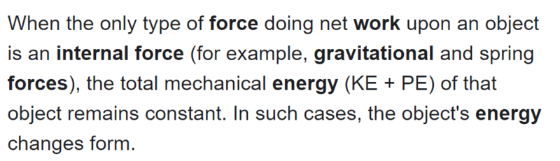

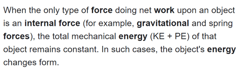

My understanding is that gravitational fields produce an "internal force" (weight) on objects and hence gravity cannot change the total mechanical energy of an object.

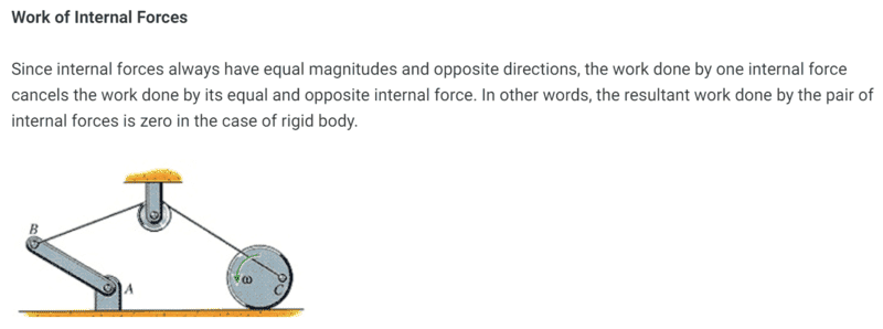

But in a free falling situation there is no other internal force cancelling it out, so it does not seem to be an internal force according to this definition at https://www.embibe.com/study/work-done-by-internal-force-concept?entity_code=KTWP26
Diagram of a rigid body with a pivot-mounted bar labelled A and a point B connected by a cord over a pulley to a wheel rotating with angular velocity ω on a surface.
Gravity is not generally considered an internal force, unless you are considering the two bodies as one system. Why don't you post what you think the definition is?
Its not completely wrong (usually internal forces are conservative and external forces non conservative) but a more accurate description would be to say conservative force instead of internal force.

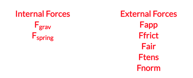

So what is an "internal force" in physics? Is it any force that is on the inside of a boundary that you define as a system? Is it always on the inside of an object? Does it alway an opposite that cancels it out if it is inside an object as the first reference states? Its term that seems to pop up a lot.

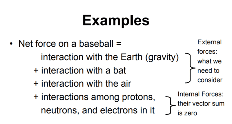

OK so does this one sound better? It defines an external force as being on a body if there is an external body causing it...and vice versa...sound legit? Nothing about being inside or outside a system and nothing about being always associated with conservative or nonconservative forces. (From Lecture 5, Purdue University Physics).
But my problem is that makes gravity (weight) an external force and that makes statements about the association between it being conservative and internal wrong.
Slide titled Examples: net force on a baseball equals gravity from the Earth plus a bat, air, and internal interactions among protons, neutrons and electrons; braces mark external forces as those to consider and internal forces as summing to zero.

Internal force is about as you say. More precisely if we have a system of bodies (for example two bodies connected by a spring) then any force between any two bodies of the system is an internal force. From Newton's 3rd law, if body 1 exerts a force ##F_{12}## to body 2, then body 2 exerts an opposite and equal force ##F_{21}## to body 1 and it is ##F_{12}=-F_{21}##. So when we take the sum of internal forces inside a system it always equal zero.
Deep down what is internal force and what is external it depends on how you define your system of bodies. In post #8 we take as system all the different parts of an object (could be all the protons and all the neutrons of the object for example).
I think maybe the point from that website is that only conservative forces are capable of being internal forces. Gravity is an internal force in the system that consists of the two bodies - the two bodies when considered as a single thing are not affected by the gravity between them.Friction doesn't work like this. When heat is released into the environment by friction, the two objects that are moving against each other are incapable of treating that force between them as internal, because they are losing energy to the environment.

The equal-but-opposite internal forces discussed in your example (the cable and pulley) never cancel each other out. The phrase "cancel each other out" in this context refers to a pair of equal but opposite forces that act on the same object. These forces act on different objects. One force acts on the pulley, the other force acts on the cable. In the case of an object in free fall, one force acts on the object, the other force acts on the Earth. (Note that these forces are equal and opposite in accordance with Newton's Third Law.)
Your efforts at distinguishing internal forces from external forces has led you down a rabbit hole. It's not the forces themselves that make the distinction, it's the circumstances. For example, for a freely falling object the force of gravity acting upon it is an external force. But if you include planet Earth in your system then that very same force is an internal force. It's all about what you decide to include in your system.
