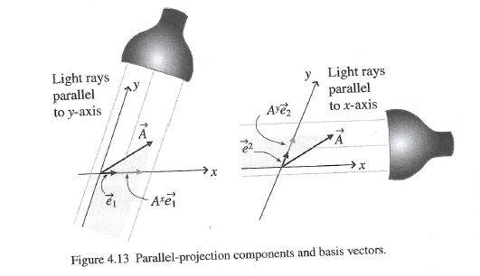

Two side-by-side diagrams of parallel projection in a 2D coordinate plane with x and y axes, each with a light source on the right or top shining light rays parallel to the y-axis (left) or x-axis (right); vectors A, e1, A^x e1, A^y e2 and e2 are labeled, with A^x e1 and A^y e2 shown as projections of A.

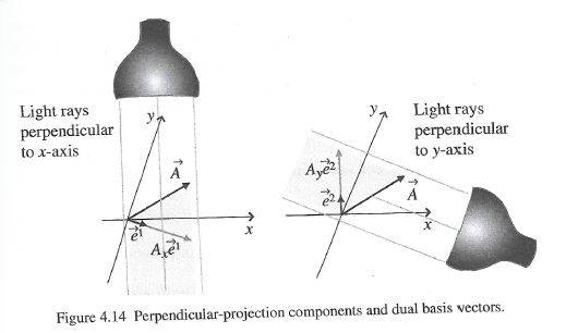

Two side-by-side diagrams of perpendicular projection onto x and y axes, with dual basis vectors e-superscript-1 and e-superscript-2 and vector A, shown inside light-ray beams from a light source.
Then he writes: "The second defining characteristic for dual basis vectors is that the dot product between each dual basis vector and the original basis vector with the same index must equal one (so ##\vec e^1 \cdot \vec e_1=1## and ##\vec e^2 \cdot \vec e_2=1##). The figures show that basis vectors and dual basis vectors with different indices are perpendicular to each other, so their dot product equals zero. So far, so good. Then, in order for the dot product between basis vectors and dual basis vectors with the same index to equal one, they should be in the same direction. But the figures show that they are not in the same direction. How can their dot product then equal one?→
The defining property for ##\vec e^1## is not only ##\vec e^1 \cdot \vec e_1=1##, but also ##\vec e^1 \cdot \vec e_2=0##, so it has to be orthogonal to ##\vec e_2##.
Yes, ##\vec e^1## has to be orthogonal to ##\vec e_2##. This is obvious from the figures and this is not my problem. My question is, why is ##\vec e^1 \cdot \vec e_1=1##? According to the figures, this should not be the case.

You cannot tell that from the figure. It is chosen so that holds. The fact that is orthogonal to ##e_2## fixes the line it lies on. Then it cannot be orthogonal to ##e_1##, therefore ##e^1\cdot e_1 \not = 0 ##. If this is not equal to ##1##, then change the length of ##e^1## to make this product equal to ##1##.
I see. So this is a matter of definition. ##\vec e^1\cdot \vec e_1=1## by definition. Thank you very much.

The dual basis is not necessarily parallel to the original basis. It is the case if and only if the original basis is orthogonal. The relation ##\vec e^a \cdot \vec e_b= \delta^a_b## is what defines the dual basis.
There is no requirement that either the dual basis nor the original basis consists of normalized vectors. In fact, in many situations you may not even have an inner product but the dual space and original vector space are still well defined.

the reason this was so confusing to me is I had not read the book referred to, and it uses different conventions from what I assume as a mathematician. (see link below for the book) in particular he is not working with orthonormal bases in spite of using the letters ej that usually imply that. as always, one has to know his definitions in order to understand his statements. (See post #8, Orodruin, second sentence, for a succinct statement of the correct definition. I wrote the following lengthy explanation before noticing post#8.)
recall that. if e1, e2 is an orthonormal basis, and we write any vector v = a1e1 + a2e2 in terms of this basis, then we can recover the coefficients a1, a2, just by dotting v with e1 and e2. i.e. a1 = v.e1 and a2 = v.e2.
In the author's system this fact means the basis is self dual. I.e. for him the dual basis B* of a basis B is the basis that gives the coefficients of B-expansions by dotting.
This is actually the usual mathematical definition of dual basis. I.e. if v,w is any basis B for the space V, then the dual basis B* is a basis of linear functions, i.e., a basis f,g for the dual space V* of linear functions on V, such that f(v) = g(w) = 1, and f(w) = g(v) =0. Then if u = av+bw, we get a as f(u) and we get b as g(u).
Now when we have a dot product on V, we can ignore V*, since then every linear function on V has form u.( ) for some u in V. Thus the dual basis for the basis B = {v,w}, will be the unique basis {u,z} also for B, such that u.v = z.w = 1, and u.w = z.v = 0.
Thus in the author's system, given a basis e1,e2, NOT assumed orthonormal, the dual basis is the unique basis e^1, e^2, such that e1.e^1 = e2.e^2 = 1, and e1.e^2 = e2.e^1 = 0. (This agrees with Orodruin's second sentence In post #8.) This dual basis will also not be orthonormal if the original basis was not.
Also, if the original basis was not orthogonal, then since e^1 is perpendicular to e2, but e1 is not, then e^1 will not be parallel to e1. etc...
