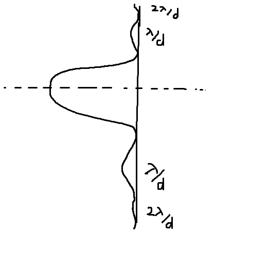

Part(d): Find an expression for y
Part (e): Sketch the interference pattern on screen and locate maximas

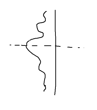

Part (f): One slit is covered by a film that reduces amplitude by half. Explain how the interference pattern changes.

Part(e)
For small angles, ##sin \theta \approx \theta##:
Maxima: ## \theta_{max} = \frac{n\lambda}{d}##
Part(f)
Using Method of Phasors:
Phase difference ##\delta = kd sin \theta##.
[tex]u_r^2 = (\frac{u_0}{r})^2 + (\frac{u_0}{2r})^2 + 2 (\frac{u_0}{r})^2\frac{1}{2}cos (\delta)[/tex]
[tex]I \propto u_r^2 = I_0\left( \frac{5}{4} + cos (kd sin(\theta))\right)[/tex]
Maximum Intensity:
[tex]kd sin \theta = 2n\pi[/tex]
[tex]\theta_{max} = sin^{-1}(\frac{n\lambda}{d})[/tex]
[tex]\theta_{max} \approx (\frac{n\lambda}{d})[/tex]
Minimum Intensity:
[tex]kd sin \theta = (\frac{2n+1}{2})\pi[/tex]
[tex]\theta_{min} = sin^{-1}\left( (\frac{2n+1}{4d}\lambda \right )[/tex]
[tex]\theta_{min} \approx \left( (\frac{2n+1}{4d}\lambda \right )[/tex]
Incomplete destructive interference so no regions of zero intensity and regions of maximum intensity now lower than before.
