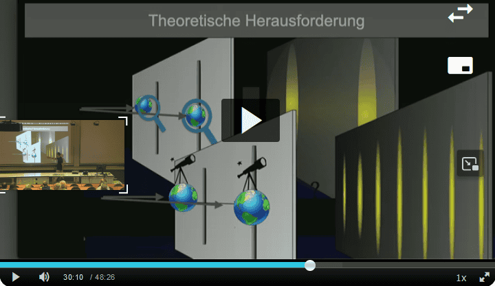

Trying to find that article, I came across this lecture for the general audience:
https://scientifica.ch/event/vom-versuch-das-groesste-mit-dem-kleinsten-zu-vereinen/
It's in German, but the slides at 30:10 illustrate the point the professor is trying to make: If the double slit experiment is performed with structures that count as observers themselves, the "equations of quantum mechanics" predict that they will see interference, while an outside observer will not.
I'm not sure what "equations of quantum mechanics" he exactly means, but are those conclusions generally accepted? After all, the professor is co-author of the (in)famous Frauchiger-Renner paper which seems to be pretty controversial.
Also, are Wigner's friend experiments like this one really considered a major challenge in the reconcilability of QM and GR?
