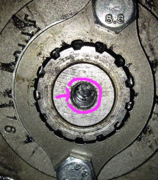

i'm a owner of a Honda Africa twin, which unfortunately has the crank shaft( where the pinion has to be inserted ) that has the teeth a bit worn.
So i opted for a modify :
I drilled the crank shaft , threaded the hole, then I screwed a prisoner m6 steel 8.8 with thread lock strong , so I paired two pinions(to expand the contact surface) and ended it all with a big washer and a simple self-locking nut.
I give you some data:
- Diameter of the shaft ( at the top of the teeth ) = 25mm
- Diameter of the threaded hole = 6mm
- Threaded hole depth = 16.2mm
- Shaft length ( from the point of exit from the crankcase to the end ) = 22,8mm
The question is:
In light of these measures ,is it possible to estimate the safety of such a change ? the crank shaft is potentially subject to breakage ? you think I'm a fool to ride the bike with this change ? The motorbike has more or less 50 horse power.
thank you so much for the help!
Maybe the right term is counter shaft or output shaft. Anyway this is a picture of the threaded hole, where then i screwed the prisoner
http://imageshack.com/a/img910/6312/gcsSTn.jpg
where is the location of the drilled hole, on the end of the shaft, or radially into the shaft?

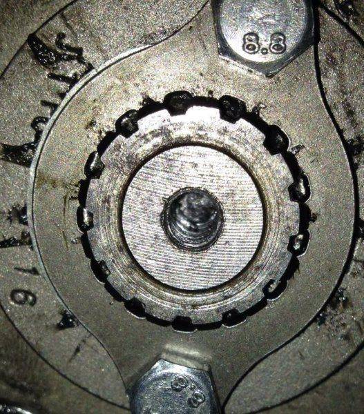

Hi!
The drilled hole is on the end of the shaft. I try to post a photo again
Thank you for the help!

Definitely less off a stress raiser than if it was drilled radially for a torsional load.
The depth of the drilled hole (16.2mm) seems fine as long as thread engagement is at least 1.5 times the diameter (6 x 1.5 = 9)
I have owned 5 motorcross bikes and 2 street bikes in my life, did all my own maint. and rebuilds and there were models that had the ends of the countershafts drilled for certain reasons but not to locate and secure gearing.
I would definitely clean up the mushrooming of the drilled hole, radius the edge. Square edges and drilled holes are stress raisers.

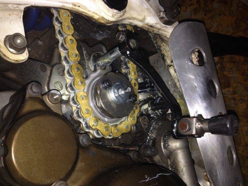

I would like to see the washer locating and securing the gears, it has to be a very large diameter due to the ID of the gear, correct?.
The original gear was secured to the shaft with an external snap ring correct?
Can you slide the gears on and put the washer and bolt on and take a photo? I am wondering where the washer seats on the shaft vs gears.
Hi Dennis, this is the job completed, with the prisoners screwed, the second front sprocket mounted, the washer and the self locking bolt. Everything is very solid an well locked. As i said, my only question is if the countershaft/output shaft, with the hole i made in the center, has become weak or "ready to break". I don't understand what do you mean when you say "mushrooming of the drilled hole, radius the edge. Square edges and drilled holes are stress raisers". I have just drilled the hole, cleaned it, and made the threads.

I would clean the edge of the drilled hole, if you run your finger over the edge is it smooth or is there a lip there? see photo

My fear would be the fastener failing / thread stripping etc, not the shaft failing. It looks like a nylon lock nut on there, I would use that or doublenut it or possibly even safety wire it to keep it from loosening.

Well, if you tell me that my fear for the breaking hasn't a reason, then i will secure it better with a safety wire, or a doublenut, or a threadlocker i thought...and live in peace :)
Don't use red threadlocker (Loctite) you need heat to remove the fastener (according to manufacturer) where the blue you do not.
Also the critical time will be during acceleration loads, (and deceleration). take it easy for a while. This is for street use correct (normal design loads), your not racing it are you? Also think about failure, what is going to happen to your leg if it fails. do you have a sprocket guard?
